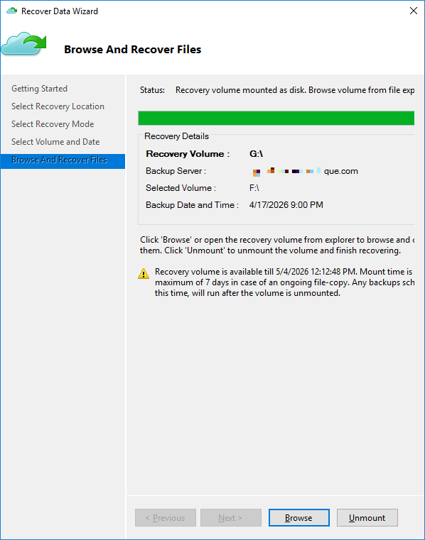

    Hi, once again I'm stuck after trying to mount a snapshot:
    However this never ends, G: drive is mounted but inaccessible:
    A corruption was discovered in the file system structure on volume G:.
    A file system index structure contains entries that violate ordering rules. The file reference number is 0x5000000000005. The name of the file is "<unable to determine file name>". The corrupted index attribute is ":$I30:$INDEX_ALLOCATION".
    It has been like this for more than 12 hours.
    Please assist this is urgent.
