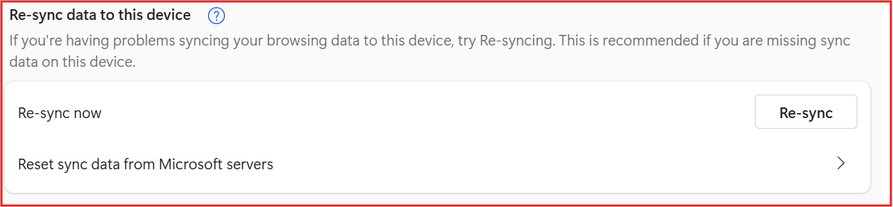

    In addition to the Q&A Assist AI response, even though the sync is turned on and active but the passwords haven’t been restored yet, you can click Re-sync now on the Sync Settings page for that particular device to manually re-sync the data.
    Here's the screenshot :-
    2025-11-09T02:34:56.3766667+00:00
