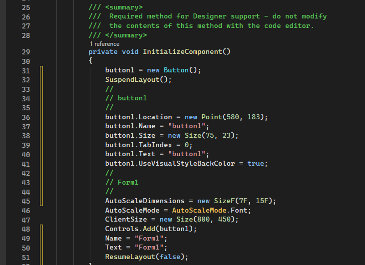

When I create Windows Forms App project, and I add a button into the form, in the Form1.Designer.cs there is a text
/// <summary>
/// Required method for Designer support - do not modify
/// the contents of this method with the code editor.
/// </summary>
So my question is - can I legally modify that method, or anything else if I will see that or similar text again? Is it just a warning or recommendation, but is not prohibited, licensed, etc.? Or is it prohibited, and I should only modify anything through Properties? What if I want or need to modify it thorough the code editor?

Screentake

    Regarding your concern, you are not legally prohibited from modifying that method. The comment you’re seeing (“do not modify…”) is not a license restriction or legal rule, it’s simply a warning from the tooling.
    That method (InitializeComponent) lives in the Designer file and is auto-generated by the WinForms designer. Whenever you drag and drop controls or change properties in the UI designer, Visual Studio rewrites that code for you.
    Because of that, modifying it manually can lead to a couple of issues:
    • Your changes may be overwritten the next time the designer runs
    • The designer itself may become out of sync or break, making the form hard to edit visually
    So while you can edit it, it’s not recommended unless you fully understand the implications.
    I would suggest these approaches:
    • Use the Designer (Properties window / drag-and-drop) for UI changes
    • Put your custom logic in your main form file (Form1.cs), not in the designer file
    For example, instead of changing button properties inside InitializeComponent, you can safely do it like this:
    public Form1()
        InitializeComponent();
        button1.Text = "Click me";

    The comment in Form1.Designer.cs is a technical guideline, not a legal or licensing restriction.
    The Windows Forms Designer generates and maintains the code in InitializeComponent and the rest of the *.Designer.cs file. Editing it manually is allowed, but not recommended because:
    • The designer can overwrite or remove manual changes the next time the form is edited in the designer.
    • Incorrect edits can easily break the designer or the form layout.
    Supported and recommended approaches are:
    • Change control properties and layout through the Designer surface and the Properties window. The designer then regenerates InitializeComponent for those changes.
    • For custom logic, event handlers, and other code, use the main form code file (for example Form1.cs) rather than editing the designer file directly. Event handlers are added in the code file, not in InitializeComponent.
    Designer-generated members can be controlled via properties such as Modifiers and GenerateMember in the designer, which then affect the generated code rather than requiring manual edits in the designer file itself. For example, changing a control’s Modifiers to Protected or Public allows inherited forms to work with that control, and setting GenerateMember to false prevents a field from being generated.
    So modifying the method is technically and legally allowed, but it is unsupported and fragile; use the designer and the main code file for changes whenever possible.
