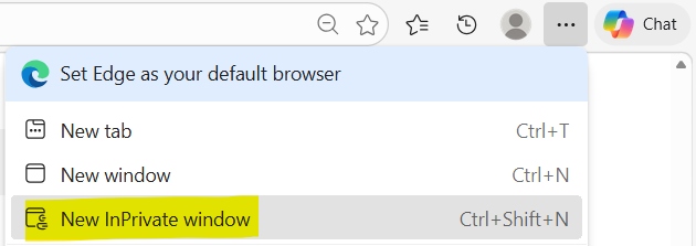

    Besides, you can try sending the invite from a private/incognito browser window. This method can help you bypass potential browser cache issues or conflicting extensions that might be interfering with the invitation process.
