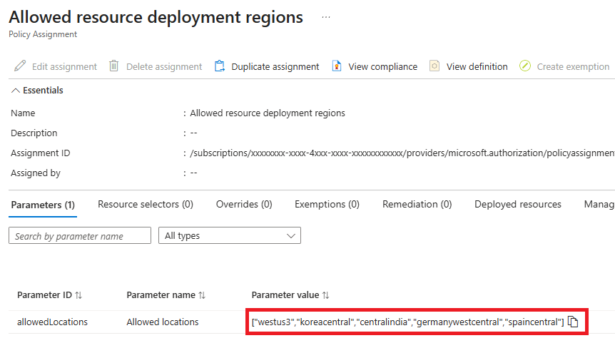

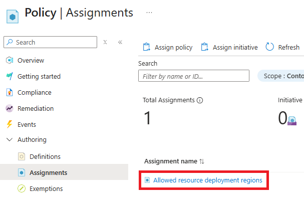

    Azure for Students subscriptions have region‑based deployment restrictions. Each subscription is typically limited to a small, predefined set of Azure regions (usually up to five), and the allowed regions can vary from one student account to another.
    To view the specific regions permitted for your subscription, you can check the Azure Policy assignment that enforces this restriction:
    1. Go to Azure Portal → Azure Policy → Authoring → Assignments
    2. Open the policy assignment named “Allowed resource deployment regions”
    3. Review the list of regions defined in that assignment
    These policy settings determine where resources can be deployed and will block deployments to any region not explicitly listed.
    Click on assignment named Allowed resource deployment regions
    Examine Allowed locations Parameter value for list of regions, similar to below (regions in screenshot are different than yours):
    The regions shown in your Parameter value are the ones you are allowed to deploy resources to. Please try to create resources in one of these regions and let me know the results.
