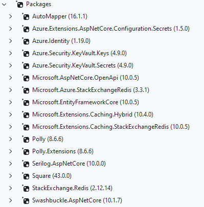

I have an App Service configured where I have my API deployed. I created an Azure Managed Redis that my API is trying to access via C# .NET 10 and I have these packages being used by my API
Using this simple API to validate the Azure setup and configuration.

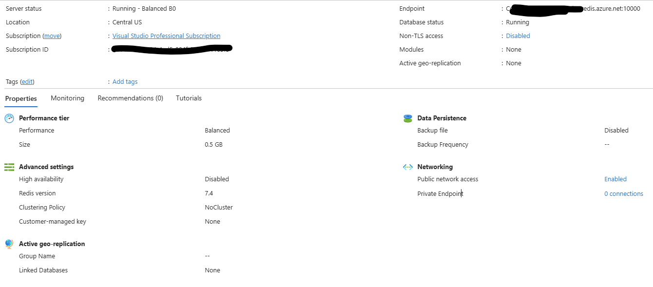

Here is my Redis Overview

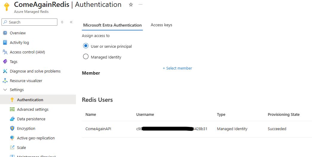

  1. SAI JAGADEESH KUDIPUDI 2,625 Reputation points Microsoft External Staff Moderator

    Azure-side checks Please also confirm the following:
    Your App Service’s managed identity is added under Azure Managed Redis → Authentication → Microsoft Entra Authentication
    The identity is listed as a Redis User (as shown in your screenshot)
    Connections are made using TLS (required for Entra authentication)
    You’re using the correct endpoint and port (10000 for Azure Managed Redis)
