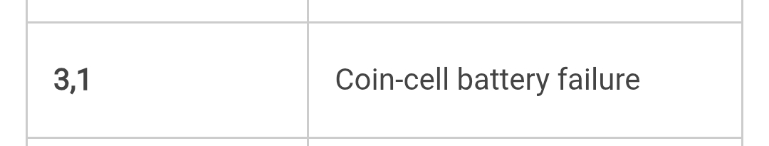

So my laptop is automatically Turing off with a click sound after 10-15 mins of use . Then when I try to turn it on , 3 amber lights and one white light blinks at the battery status indicator . I looked it up and found out that the c mos battery was dead . So I got it changed but still the issue is pertaining. Whenever I change the timings in the bios settings which one enters by pressing F2 while the laptop starts but then once it restarts it again shows the wrong time . I think the problem is there somewhere .

    1, Check the exact laptop model and match the LED code with the manufacturer’s diagnostic table.
    • If this is a Dell device, the blink pattern is read amber first, then white, and the meaning can vary by model.

    1. Consult the laptop manufacturer’s documentation for the exact LED blink code (3 amber, 1 white) to identify the failing component (often system board, battery, or power subsystem).
