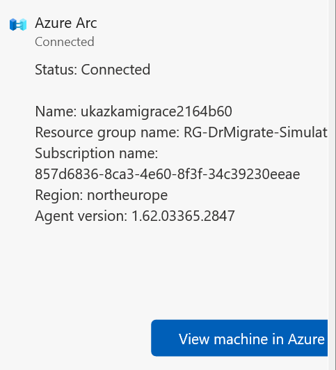

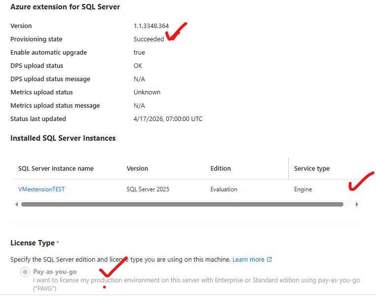

Despite SQL Extension pipeline issues (knows MS bugs in extensions) , we managed prepare the server with AzureConnectedMachineAgent and SQL Arc Extensions. We tried to install the SQL Server through Use pay-as-you-go billing , but it seems there is policy issues within Windows Server Datacenter 2022.

    We prepared a the SERVER fully ARC Enabled through the process:
    run RegisterSqlServerArc script for LicencedOnly type, so we have WindowsAget.SQLServer extension ready, and then run .\modify-arc-sql-license-type_offset.ps1as  (second, third attachment)
    All is ready as showed in attached .zip
    Then we do not have binary installation of SQL Server without Evaluation element, so we run classic SQL2025-SSEI-Eval installation for SQL Server , there is no option to go for PAYG during SQL setup
