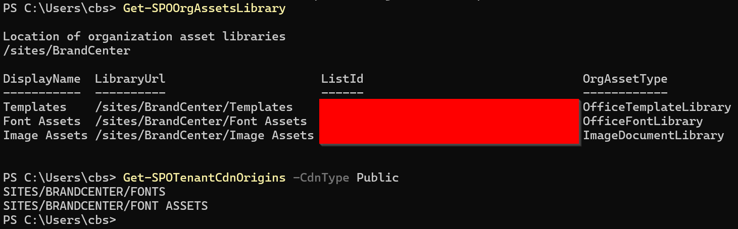

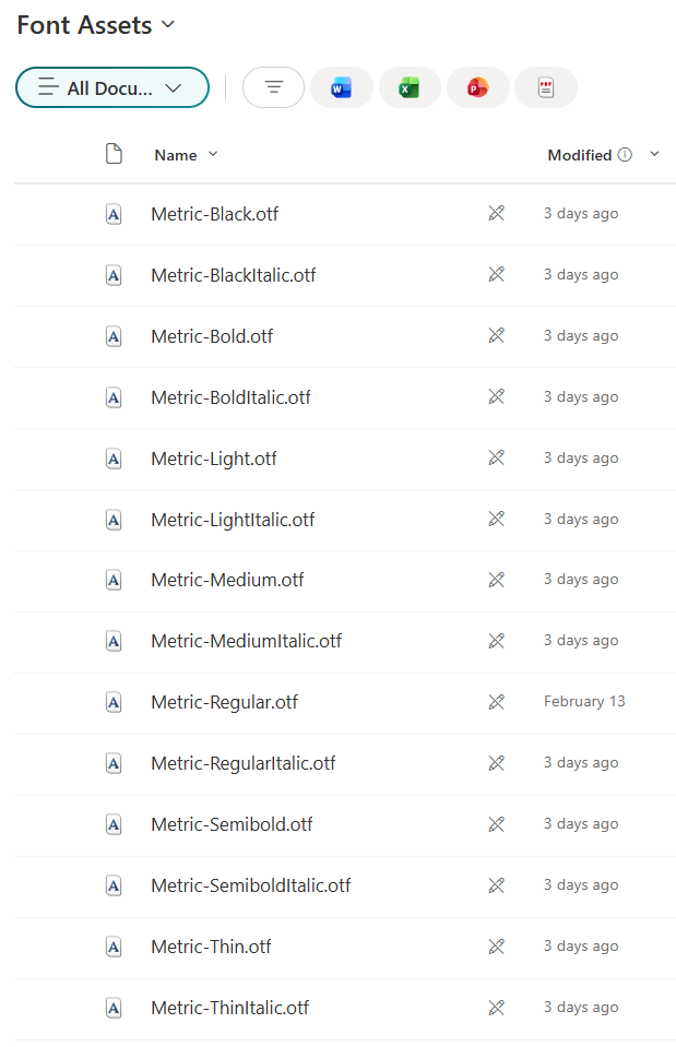

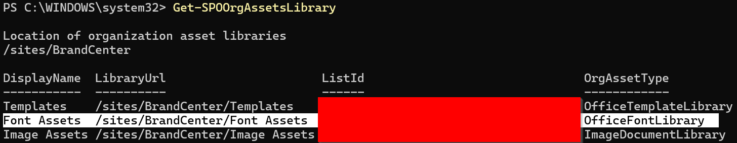

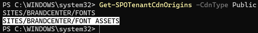

We have deployed organizational fonts via the SharePoint Brand Center, and the fonts are available in the asset library (publicly accessible as required).
However, we are observing the following:

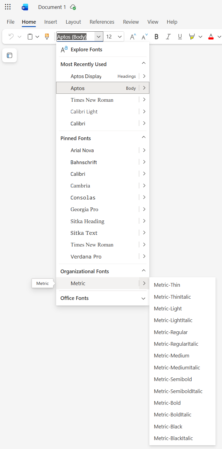

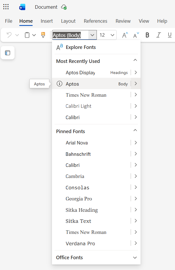

  • The fonts do not appear in Word or PowerPoint desktop client apps
  • The fonts do not appear in Word/PowerPoint web apps
We have reviewed the documentation here: https://learn.microsoft.com/en-us/sharepoint/support-for-organization-fonts-in-powerpoint-for-the-web
This documentation suggests support in PowerPoint for the web when the asset library is publicly accessible, which aligns with our configuration.

    Based on your description, I understand that you’ve uploaded organizational fonts via the SharePoint Brand Center, the fonts are present in the asset library and publicly accessible, but they are not appearing in Word or PowerPoint (both desktop and web). You’re trying to determine whether this behavior is expected, a configuration issue, or a current limitation of the feature.
    Please let me know if I misunderstood any part of your issue or if there are additional details you’d like to share.
    To help provide the most accurate and effective conclusion, could you please help clarify a few points about your setup:
    • How were the fonts deployed?
      • Were they uploaded only through the SharePoint Brand Center (Brand fonts UI), or
      • Were they also configured as an Organization Asset Library for fonts (OfficeFontLibrary) using PowerShell?
    • If PowerShell was used, was the library designated with a Public CDN?
    • Approximately how long has it been since the fonts were uploaded and configured?

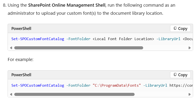

    • An Organization Asset Library configured with -OrgAssetType OfficeFontLibrary -CdnType Public.
    • Fonts uploaded via Set-SPOCustomFontCatalog -FontFolder <Local Font Folder Location> -LibraryUrl <Document Library SharePoint URL>.
    • Up to 24 hours for propagation.

    • Confirming the library is registered with Add-SPOOrgAssetsLibrary -OrgAssetType OfficeFontLibrary -CdnType Public (no /AllItems.aspx in URL),
    • Uploading fonts with Set-SPOCustomFontCatalog,
    • Waiting at least 24 hours,
    then that behavior is not aligned with the documented expectations and would point to a configuration or service issue rather than a documented limitation.
