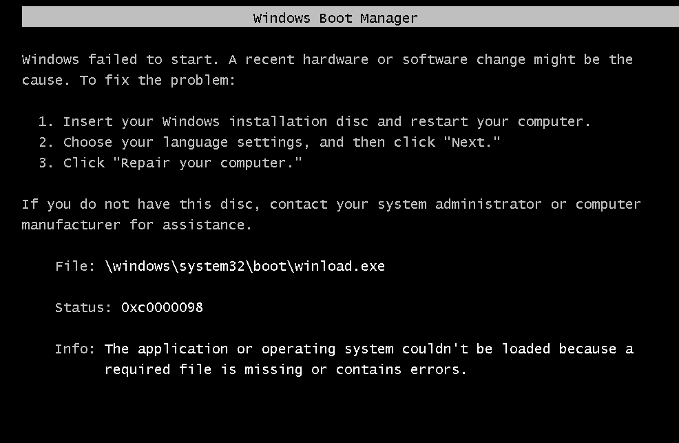

I got the issue like the following. Please help.

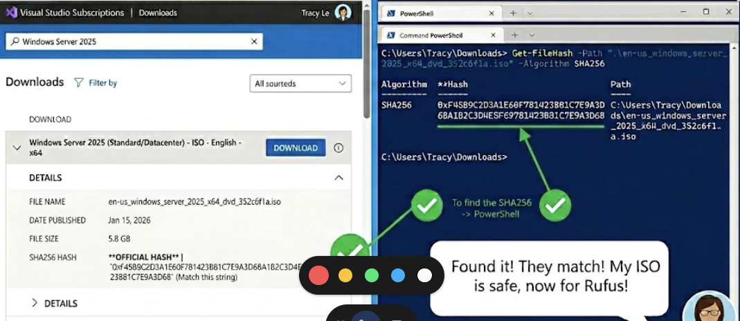

    Regarding your question: Yes, MSDN provides the official hash for every ISO. Since I cannot attach a screenshot in the comments, here is exactly what you need to look for:
    Go to your Visual Studio Subscriptions download page and search for your Windows Server 2025 ISO.
    Look at the exact row for the file you downloaded.
    Click the "Info" button (it usually looks like a small 'i' icon) right next to the blue "Download" button.
    A details box will pop up. Look for the line labeled SHA256.
    Copy that long string and compare it with your PowerShell result. If they match perfectly, your ISO is completely fine, and you just need to recreate your bootable USB using Rufus! You can see the attached screenshot for reference

    2026-04-21T03:09:47.67+00:00
    The screenshot shows Windows Boot Manager error 0xc0000098 indicating that the boot files (\windows\system32\boot\winload.exe or the BCD configuration) are missing or corrupted. Recovery must be done from proper Windows Server installation media; if the ISO or the media created from it is damaged, both setup and repair will fail.
    Use these steps:
    1. Verify the Windows Server 2025 ISO
      • If the ISO was downloaded, check that it is not corrupted by validating its SHA‑1 checksum with the Microsoft File Checksum Integrity Verifier (FCIV) tool, similar to the method used for other Microsoft ISOs:
        • Install FCIV.
        • Run in an elevated Command Prompt:
                 fciv.exe <ISO-file-name>.iso -sha1
        • Compare the returned SHA‑1 value with the checksum provided on the download page. If it does not match, download the ISO again and discard the old one.
      • If the ISO was burned to DVD, recreate the media using a high‑quality disc and a slower burn speed. A bad burn or low‑quality media can cause missing‑file errors during setup and repair.
    2. Prefer USB installation media
      • Instead of DVD, create a bootable USB drive from the verified ISO (for example, using the Windows USB/DVD Download tool or similar). This avoids many read errors that cause messages about missing or corrupt files during installation.
    3. Boot from the verified media and run repair
      • Boot the server from the known‑good Windows Server 2025 installation media.
      • Choose the correct language and keyboard settings.
      • Select “Repair your computer” instead of “Install now”.
      • Use the automatic repair options to fix startup problems. These tools rebuild boot files and the BCD store so that winload.exe can be found and loaded.
    4. If repair still fails
      • Re‑confirm the ISO integrity and the USB/DVD by testing them on another machine or a virtual machine to ensure they boot and start setup correctly.
      • If the media works elsewhere but the server still cannot boot or install, hardware issues (disk or controller) may be present and should be investigated separately.
    These steps address both the ISO/media issues and the boot‑loader error shown in the screenshot so that Windows Server 2025 setup and repair can complete successfully.
