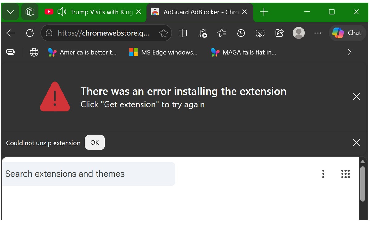

MS edge has been behaving strangely of late on my Lenovo notebook, with Win 11 Pro, ALL available Windows Updates installed, with AMD Ryzen 7 5800U, 16GB RAM, all Lenovo drivers/software up-to-date. I have used Windscribe VPN add-on for years with no issue. It suddenly stopped working with some error message and when I tried to re-install it, the process always failed. I continued using the add-on in Firefox. I think I could also not install any other add-ons, both from the Chrome & MS store.

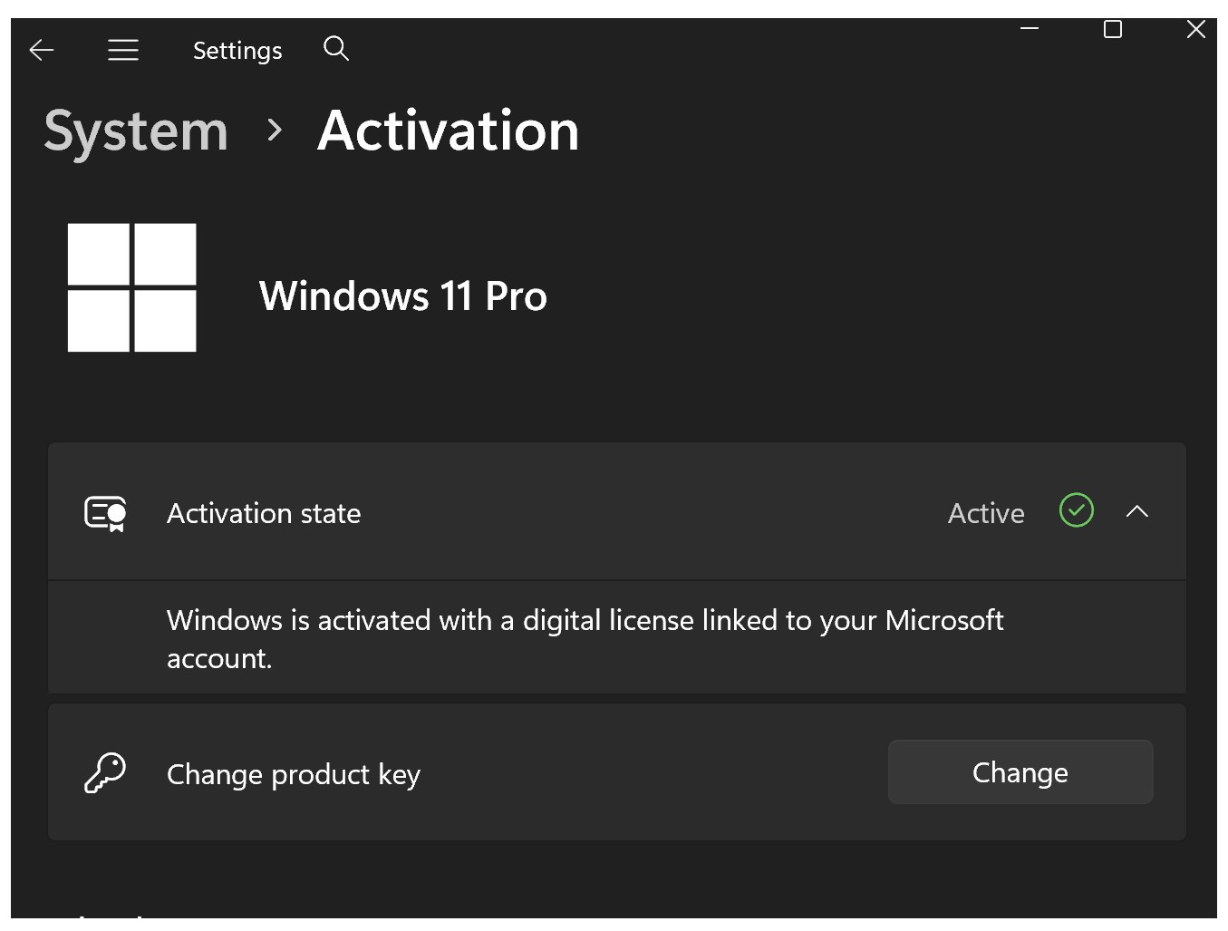

    As I understand so far, after you recover using a restore point. Your Windows is active again and Edge can be opened, am I correct? Which means the only issues left is the add-ons.

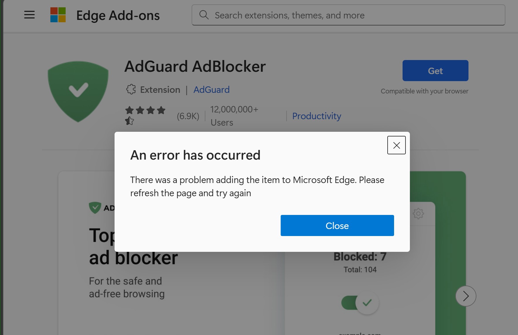

    Before we proceed, may I know what happened when you tried to download the add-ons? A photo of it would be best, but please remember to remove all personal information before posting.
    I'm waiting for your reply.

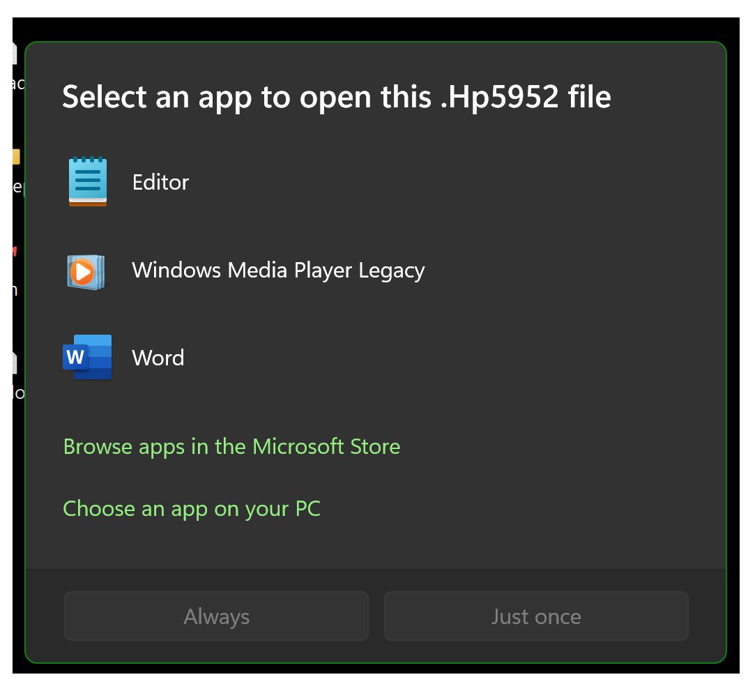

    Regarding the apps, I don't think I recognize this file name or the extension. The name "Qt_temp" might refer to an app that was built using Qt framework, and it is not a Windows component as I know of, so you should disable it from startup. A lot of everyday software was built using Qt framework, so when the apps is no longer there due to a reset or uninstallation, it could create a temp files as you see. Personally, I don't think it'll do any harm to your computer, but it has nothing to do running at startup.
    I hope this clarifies.

    This indicate that this is not a policy prevention and temp folder issue. Which leaves us with 2 possible causes.
    1. Antivirus and firewall block.
      • In this case, can you please try to disable all antivirus software, VPN and firewall (Including Windows Defender) to see if it allows you to download extensions?
    2. Repair permission on Edge folders.
      • Close all Edge instances
      • Type "Command prompt" in the search bar and select "Run as administrator"
      • Type icacls "%LOCALAPPDATA%\Microsoft\Edge" /reset /T /C and press Enter.
      • Restart your computer when it is done.
