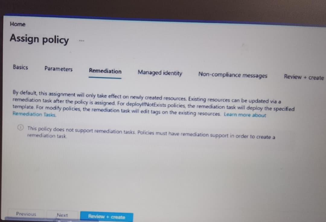

I tried deploying different azure policy to the root tenant group and the policy has remediation of deployifnotexist, but when it reaches the remediation tab the box I'm to tick in the remediation tab wont show and I'm told this policy does not support remediation tasks. but when I put it in a subscription, the remediation box will show up

    Hello @Ayiba Chinwe
    When a policy with the DeployIfNotExists effect is assigned at the tenant root management group, Azure does not support remediation tasks at that scope. Because of this platform limitation, the Remediation tab correctly shows that the policy does not support remediation, and the checkbox to create remediation tasks is not available. However, when the same policy is assigned at a subscription or lower management group, the remediation option becomes available and works as expected.
    This happens due to below following reasons:
    • DeployIfNotExists remediation tasks run ARM deployments to bring existing non‑compliant resources into compliance.
    • ARM deployments require a subscription or resource group deployment context.
    • The tenant root management group does not provide a deployment context, so remediation tasks cannot be executed there.
    • As a result, Azure Policy disables remediation tasks at the tenant root management group, even though the policy itself can still be assigned at that level.
    Remediation tasks are used to remediate existing resources and rely on ARM deployments, which explains why remediation is only supported at subscription or lower scopes and not at tenant root scope.

    2026-04-23T11:08:10.88+00:00
    At the management group (including root) scope, the policy assignment wizard does not create remediation tasks inline. The “Create a remediation task” checkbox on the Remediation tab is only supported for policy assignments at subscription scope.
    For deployIfNotExists or modify policies assigned at management group scope, the workflow is:
    1. Assign the policy or initiative to the management group (the Remediation tab will show that remediation tasks are not supported during assignment).
    2. Wait for policy evaluation to complete so that non-compliant resources are identified.
    3. Create the remediation task separately using one of these options:
      • In the Azure portal:
        • Go to PolicyRemediation and use Option 1 or Option 2 from the article to create a remediation task for the non-compliant assignment at management group scope.
      • Or via PowerShell/CLI:
        • Use Start-AzPolicyRemediation (PowerShell) or az policy remediation create (CLI) and point -PolicyAssignmentId / --policy-assignment to the management group–scoped assignment.
    This behavior is expected: the inline remediation checkbox is supported for subscription assignments, while management group assignments require creating remediation tasks after evaluation.
