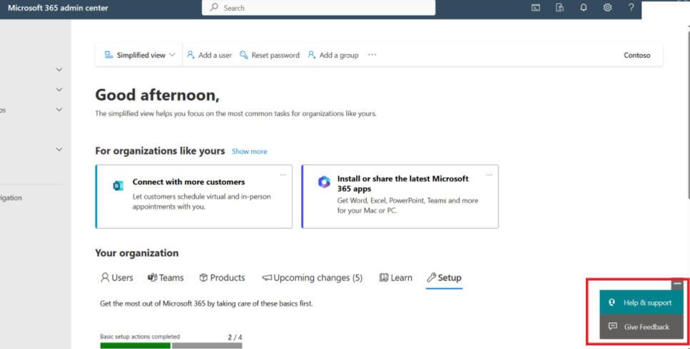

      roledefid={roleDefId}
    As for now, there is no official documents report this unexpected behavior, therefore, no known issue or Service Health report are documenting this. If this is affecting multiple tenants, you can consider opening a support ticket via Admin Center.
