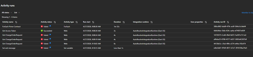

Below are the run times of the pipeline for the Get ChangeOrderRequest web activity.

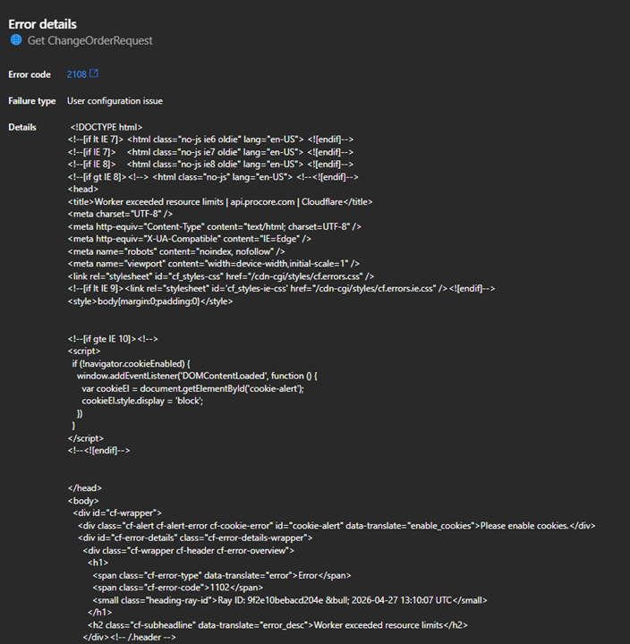

Below is the error from the third Get ChangeOrderRequest web activity.
Why didn't the Set exit message get triggered after the first Get ChangeOrderRequest web activity? Why did the other two Get ChangeOrderRequest web activities run?
