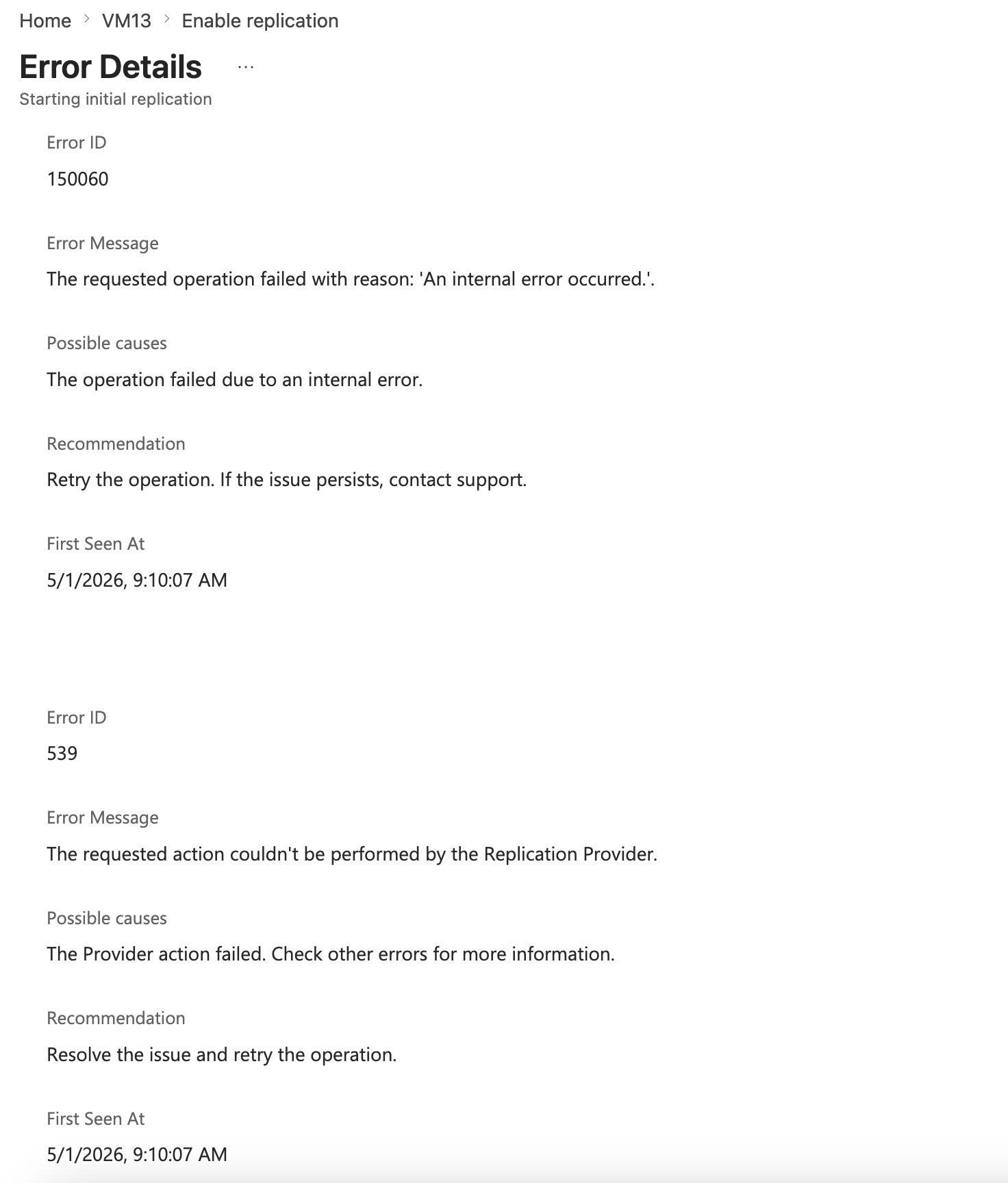

Azure Site Recovery replication failed due to internal error - error code : 150060

2026-04-28T09:05:28.4533333+00:00 Hello Kamil Bahrudin, it looks like your ASR job is hitting error 150060 "internal error".
ASR relies on the Azure VM Agent to deploy and manage the Site Recovery extension. If the agent is not in a “Ready” state, outdated, or unresponsive, replication can fail.
ASR requires outbound connectivity to Azure endpoints over HTTPS (ports 443 and 9443). Network restrictions or firewall/proxy misconfiguration can prevent replication.
Disk-related issues such as disk changes, detachments, or inconsistencies during replication can cause initialization failures. Changes to disks during replication can break sync state.

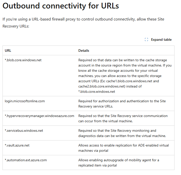

2026-04-30T09:52:33.7733333+00:00 Yes, Replication requires outbound connectivity to specific Azure endpoints (for storage, authentication, and service communication). The VM must reach endpoints such as:
login.microsoftonline.com> authentication -
*.hypervrecoverymanager.windowsazure.com> replication coordination -
*.blob.core.windows.net> data transfer

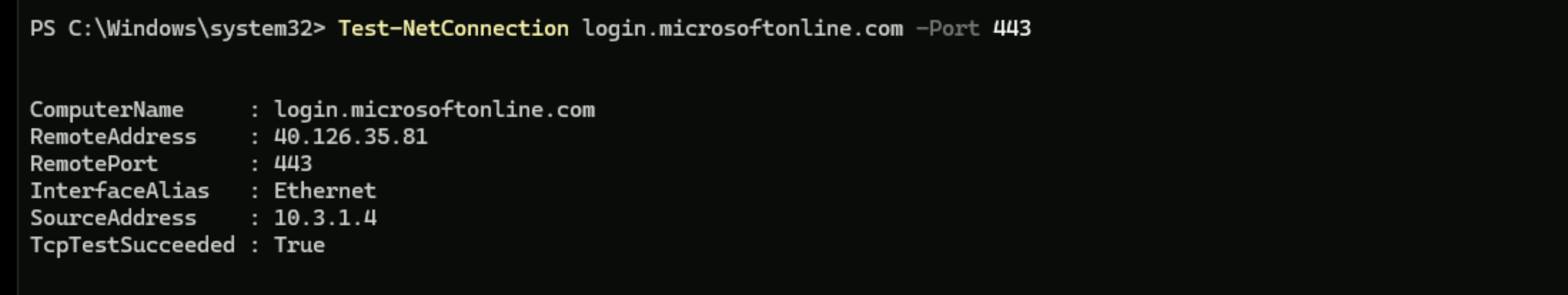

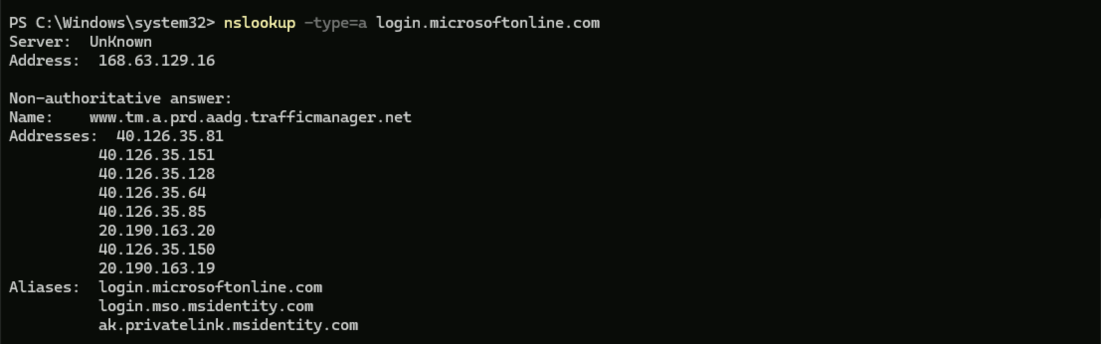

2026-05-01T01:33:25.9233333+00:00 DNS resolution is successful
TCP connection test is successful

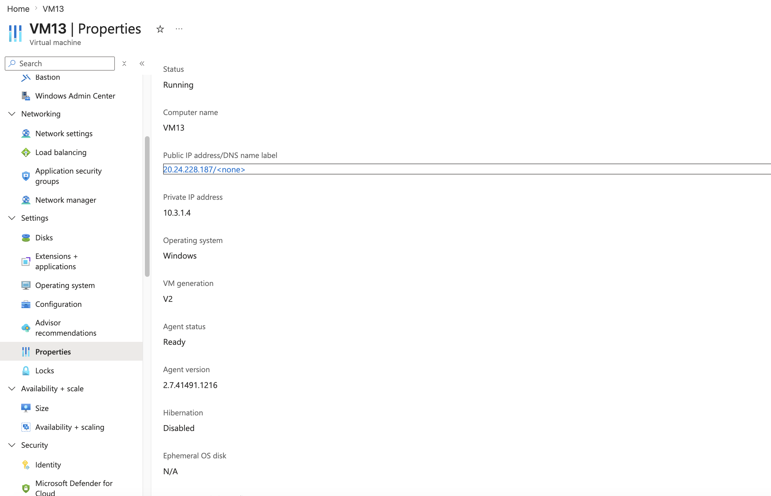

VM Status is running and VM Agent status is Ready

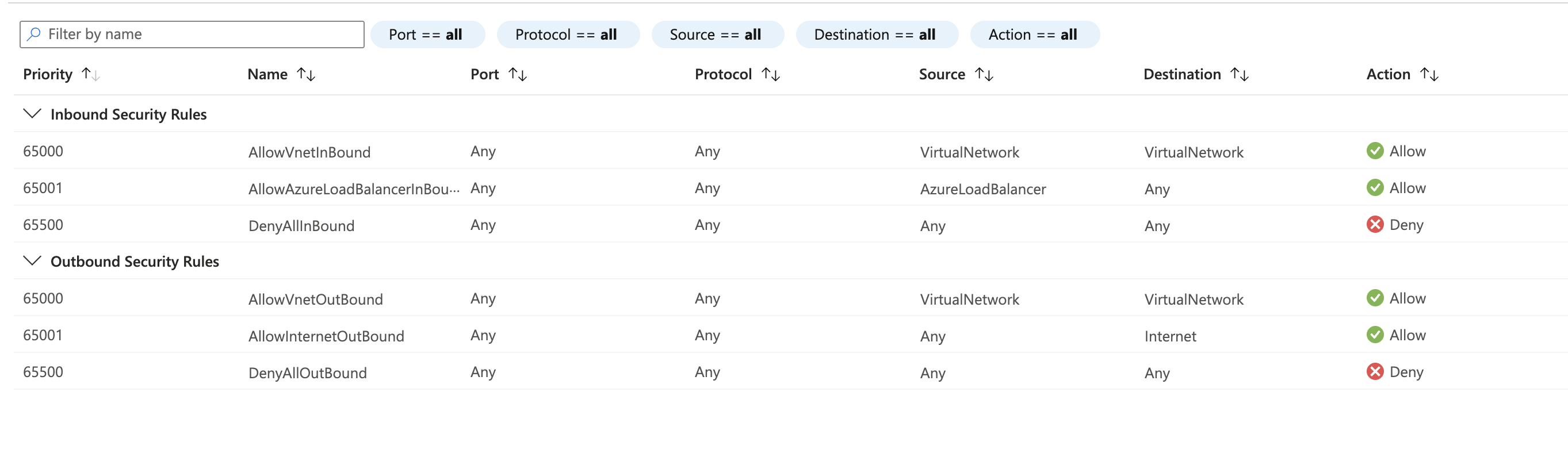

NSG allows outbound internet access

2026-05-01T02:51:07.22+00:00 Looks like there is no error and DNS, TCP, NSG, and VM Agent are all healthy. The error message "An internal error occurred" without a specific sub-reason (disk not found, sync time failure, etc.) is a generic 150060 variant. Combined with error 539 (Replication Provider failure), the actual failure is happening might be at the Mobility Service / filter driver / VSS layer on the VM.Here are few troubleshooting step you can try:
