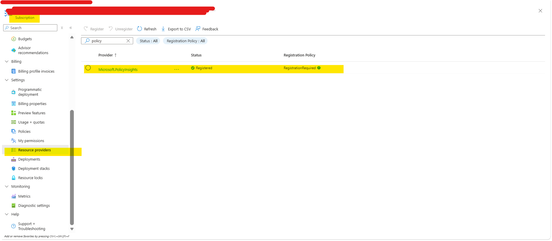

    2. Or in the Azure Portal
      • Go to your Subscription
      • Under Settings click Resource providers
      • Find Microsoft.PolicyInsights and click Register.
    After you see the registration state switch to Registered (usually takes 5–10 minutes), the Azure Policy add-on in your AKS cluster will be able to call into Policy Insights and start pushing compliance data. Once it’s registered, you can either wait for the next scheduled compliance scan (up to 24 hrs) or trigger an on-demand scan:
