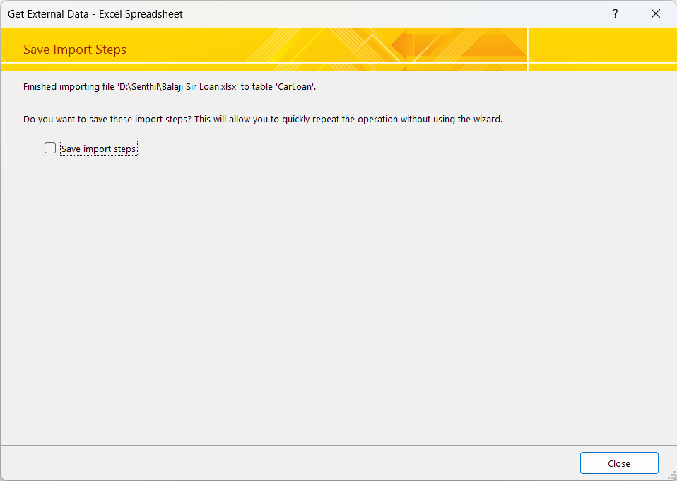

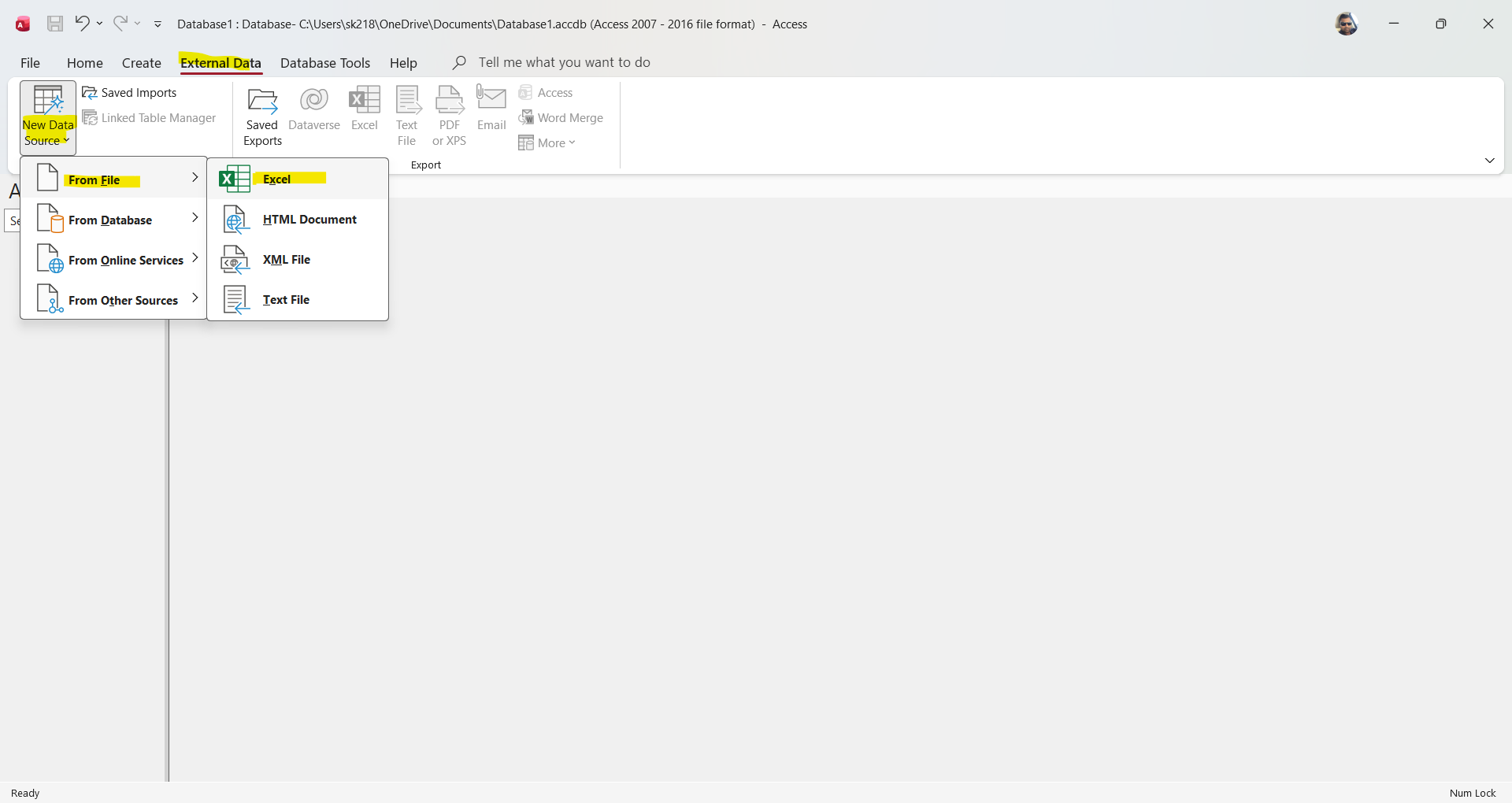

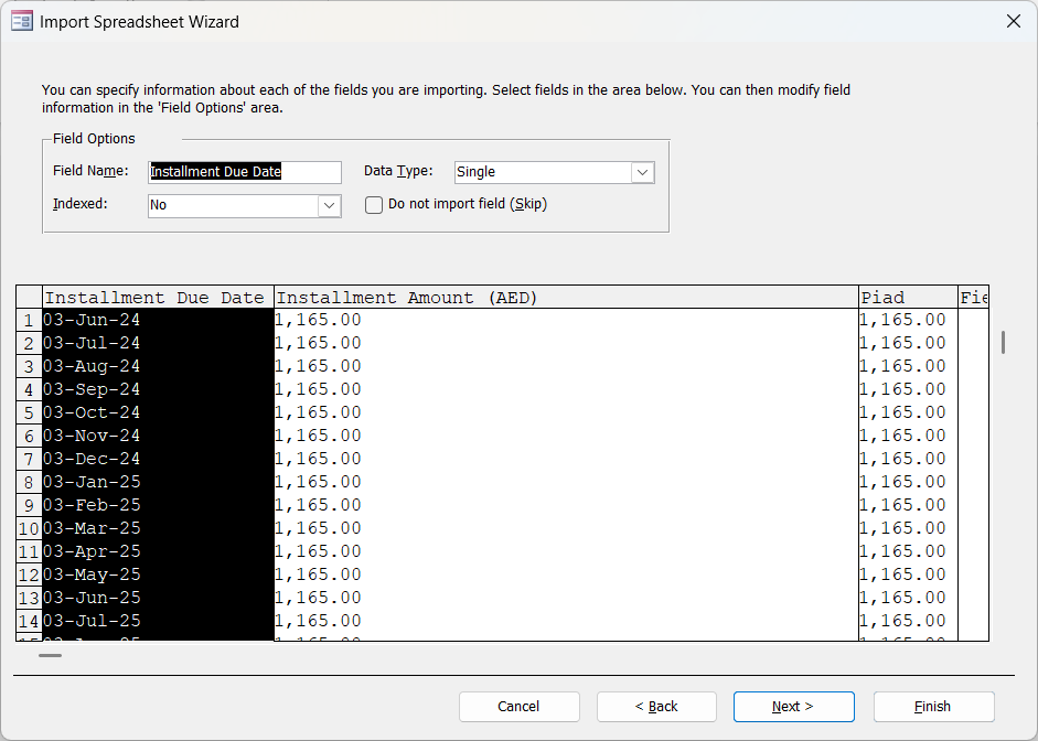

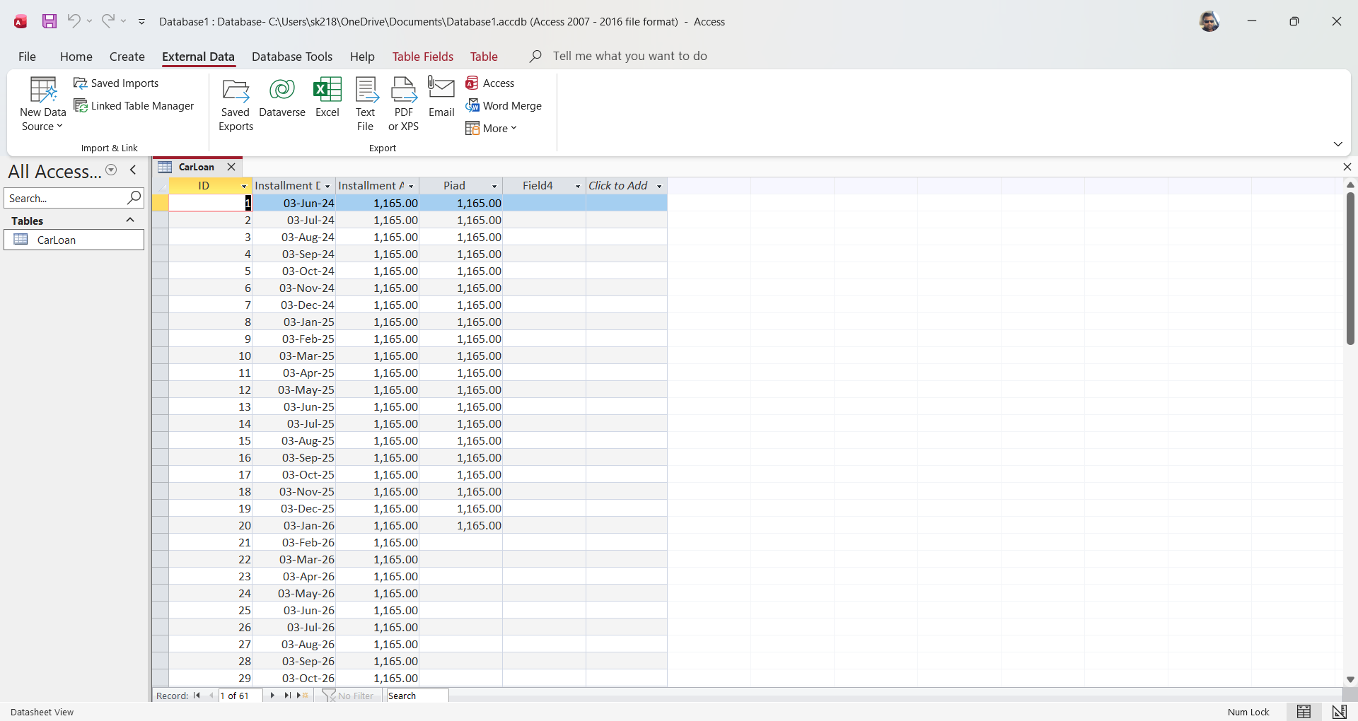

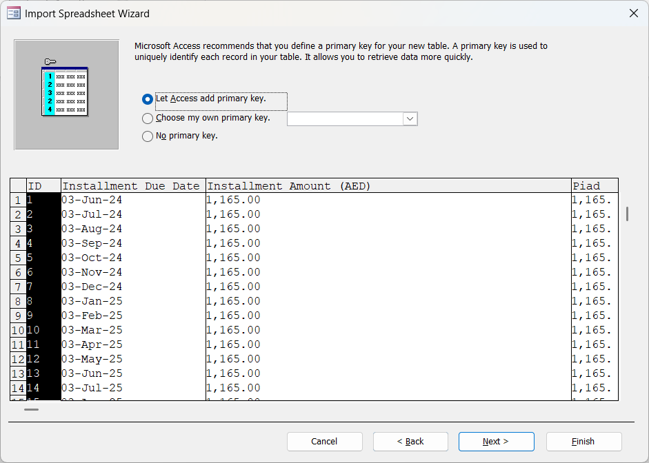

  2. Senthil kumar 110 Reputation points
    2026-04-30T15:32:39.4133333+00:00
    Hi Jackie Beedie,

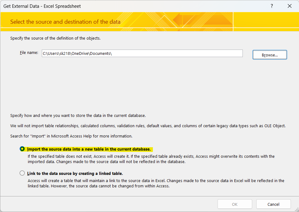

    Yes, its possible but no need any code. just import the excel file in access db.

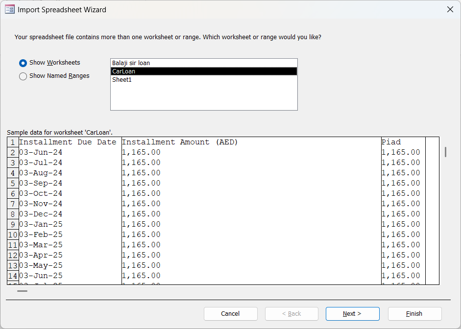

    1. browse your excel file
    2. select your sheet name

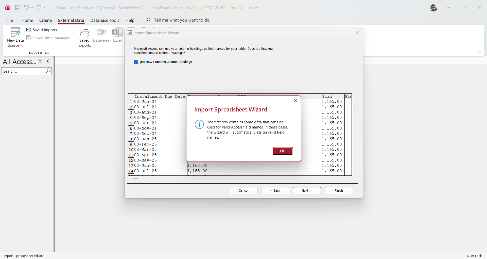

    3. tick first rows as header if you needed. otherwise no need to tick.
    4. if you want to change the datatype change from there.
    5. if you want to add primary key for your table just select let access add primary key.

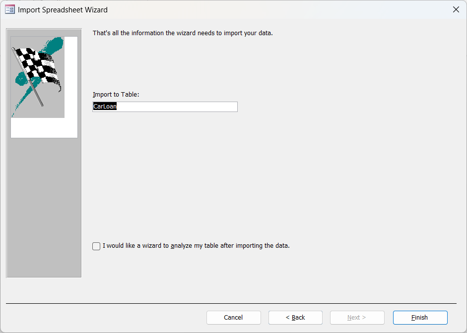

    6. give your table name. by default sheet name will appear.
    7. after finish another window will open there if you want tick save import steps. otherwise no need.
    8. then click close table will created successfully.
