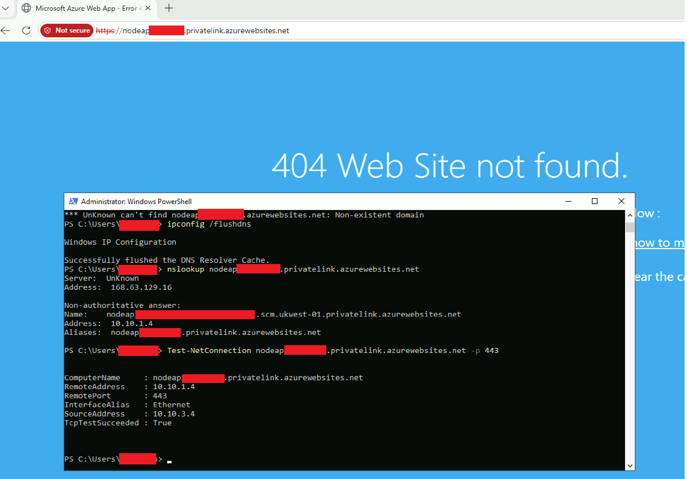

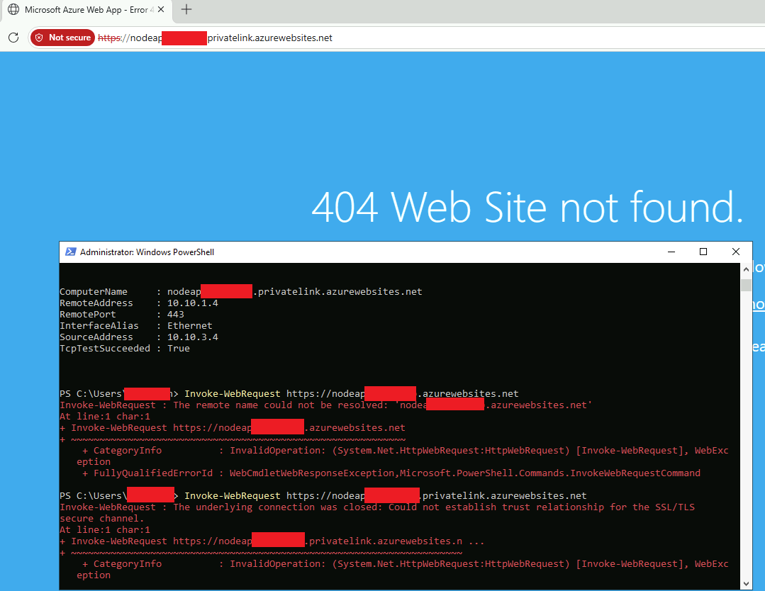

Hi all,
I’m working on a cross-tenant Azure App Service Private Endpoint configuration and am having trouble getting DNS resolution to return the Private Endpoint IP from a VM within my virtual network. I have followed Microsoft documentation and several troubleshooting guides, but DNS queries for the App Service hostname still resolve to the public IP and don't return the private IP as expected.
Scenario:
  • One tenant (Central) acts as the consumer and hosts the virtual network and a test VM.
  • A second tenant (tenant A) acts as the provider and hosts the Azure App Service.
  • A Private Endpoint is created in the consumer virtual network, targeting the App Service in the provider tenant.
  • A Private DNS zone for App Service Private Endpoints is created in the consumer tenant and linked to the virtual network.
  • The Private DNS zone contains an A record for the App Service regional private hostname that points to the Private Endpoint IP.
  • I have also tested adding a CNAME for the App Service short name pointing to the regional private hostname.

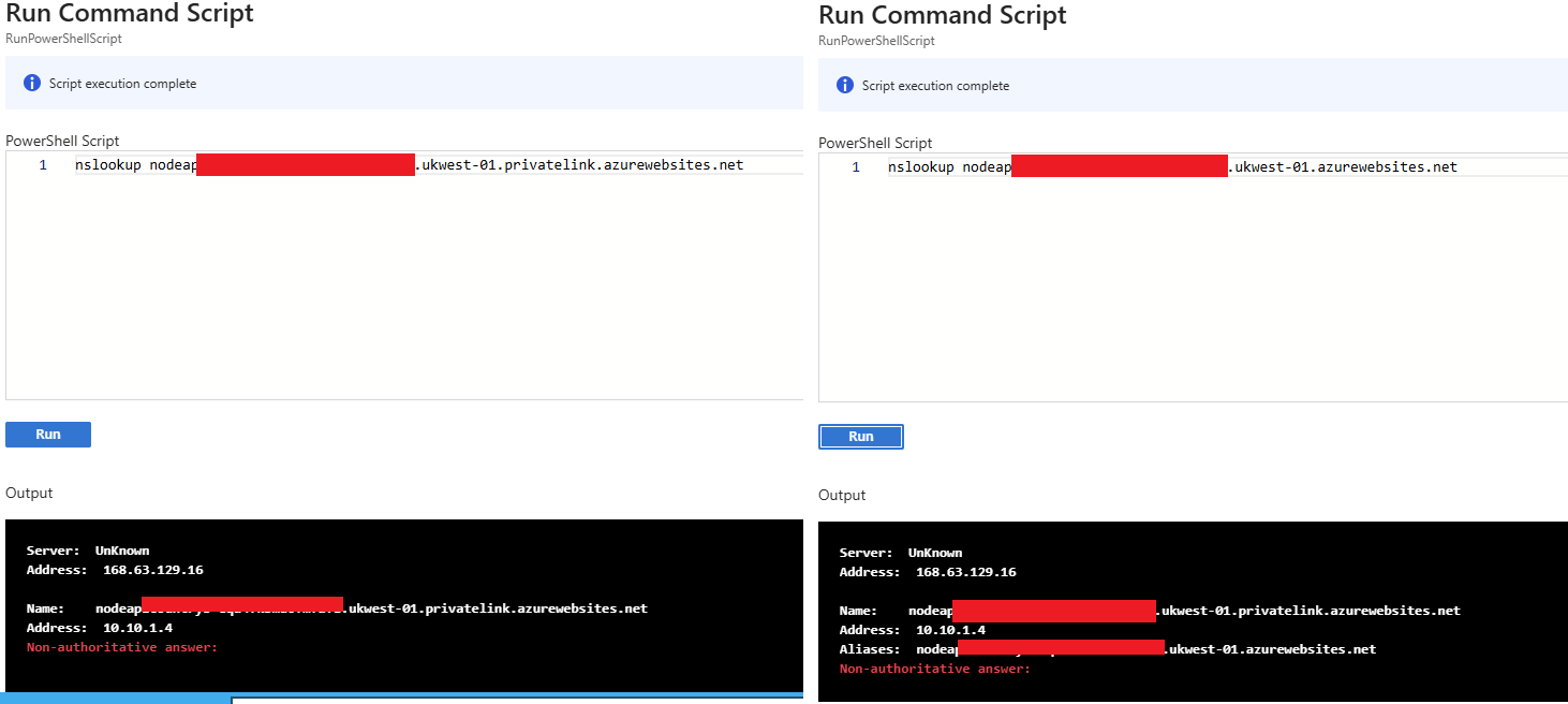

What I have tried:
  • Verified that the Private DNS zone is correctly linked to the virtual network.
  • Verified that the A record for the regional private hostname exists and points to the Private Endpoint IP.
  • Flushed the DNS cache on the VM.
  • Confirmed the VM is using Azure’s default DNS service.
  • DNS lookups for both the regional private hostname and the short hostname return “Non-existent domain.”
  • Connectivity tests to the Private Endpoint IP on port 443 succeed.
  • The App Service itself is running and accessible via the public endpoint when enabled.
  • No custom DNS servers or private DNS resolvers are configured.
Questions:
  • What might be missing in my DNS configuration for a cross-tenant App Service Private Endpoint scenario?
  • Is there an additional step required to make the regional private hostname resolvable from a VM in the consumer virtual network?
  • Do any additional DNS records need to be created manually, or is there a recommended approach for wiring up DNS in this setup?
  • Is it possible to have the standard App Service hostname resolve to the Private Endpoint IP in a cross-tenant configuration?
  • Are there any known platform limitations or common pitfalls with this type of deployment?
Thanks in advance for any guidance

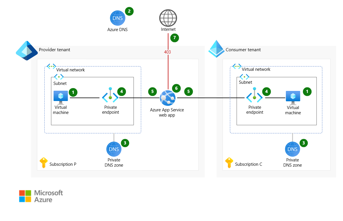

    The issue is caused by incorrect DNS configuration for App Service Private Endpoint. In cross-tenant scenarios, DNS is not automatically integrated, so you must manually create a Private DNS zone named privatelink.azurewebsites.net in the consumer tenant and add an A record for <appname>.privatelink.azurewebsites.net pointing to the Private Endpoint IP.
    The standard App Service hostname resolves via a CNAME chain to this private zone, so without the correct zone and record, DNS queries return NXDOMAIN.
    Please follow the Cross-tenant secure access to apps by using private endpoints and verify the configuration.
    Diagram that shows how a private endpoint securely connects a user on a virtual machine (VM) in one tenant to a web app in another tenant.
    Ref: Troubleshoot Azure Private Endpoint connectivity problems
    Please210246-screenshot-2021-12-10-121802.pngand “up-vote” wherever the information provided helps you, this can be beneficial to other community members.

    1. DNS flow for cross-tenant App Service Private Endpoint
    From the cross-tenant architecture:
    1. The VM queries webapp.azurewebsites.net.
    2. Azure public DNS returns a CNAME: webapp.privatelink.azurewebsites.net.
    3. A private DNS zone handles webapp.privatelink.azurewebsites.net and returns an A record with the private endpoint IP.
    4. The VM connects to the private endpoint IP over HTTPS.
    If the VM is still resolving to a public IP or gets Non-existent domain, the private DNS zone for privatelink.azurewebsites.net is either missing, not correctly linked, or doesn’t contain the correct A record.
