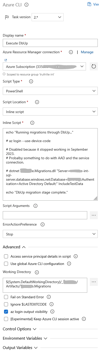

I have an Azure release pipeline that's been working for a while but suddenly the AzureCLI task fails saying Azure login failed.
Here is the task.

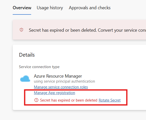

Clicking on Manage I get through to Azure that shows a warning about an expired 'secret'.
It will produce a new secret, but what do I do with it? I can't find the old one anwhere.

    Hey Richard, it looks like your AzureCLI task is failing because the underlying Service Principal’s client secret has expired. When you hit “Manage” in your classic pipeline and see that warning, it’s telling you exactly that – the secret used by your Azure Resource Manager service connection is no longer valid, so az login blows up.
    Here’s how to fix it:
    Click on Rotate secret if it is visible to auto rotate.

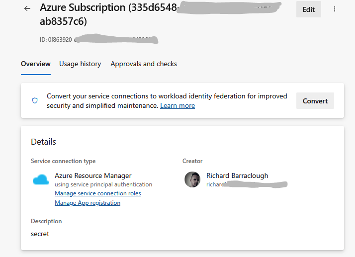

    1. Click on Manage App registration as in screenshot below. OR In the Azure Portal, go to Azure Active Directory (Microsoft Entra Id) → App registrations → find the app/service principal that backs your DevOps service connection by matching the Id mentioned below service connection name.

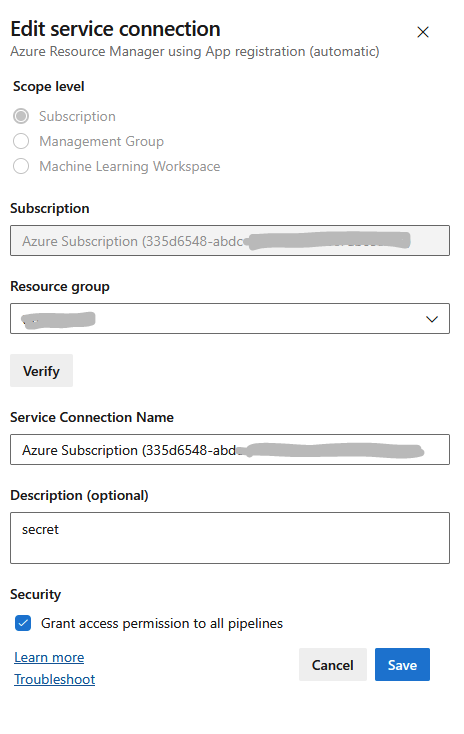

      • Navigate to Project settingsService connections.
      • Find your “Azure Subscription (xxx-… )” connection, click the … and choose Edit.
      • Under Authentication method, paste in the new secret Value you just created, click Verify (or Save), and confirm the connection succeeds.
