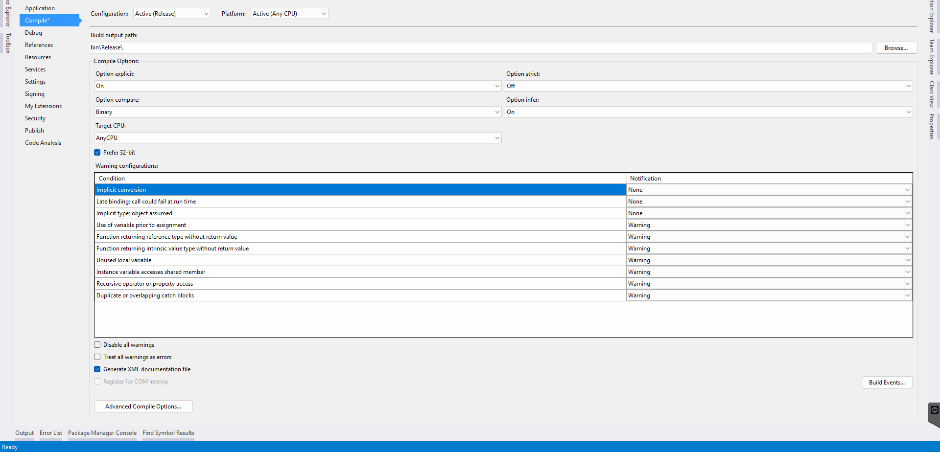

  1. Senthil kumar 110 Reputation points
    2026-05-01T15:00:05.61+00:00
    Hi Aman Agrahari,
    Please confirm your Visual studio version.
    • Go to project properties then go to compile
    • go to Target CPU select 'Any CPU' and tick Prefer 32 bit.
    • then try to run your application.
    vs
    Thanks
