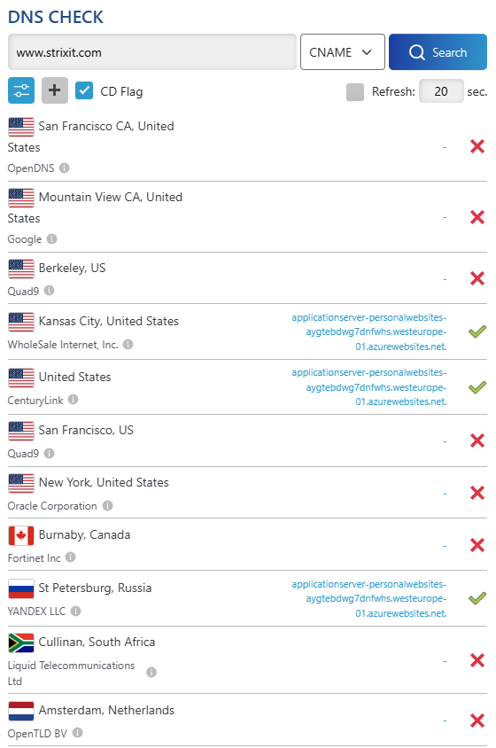

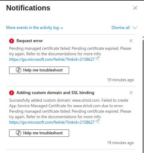

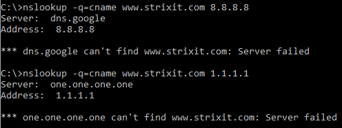

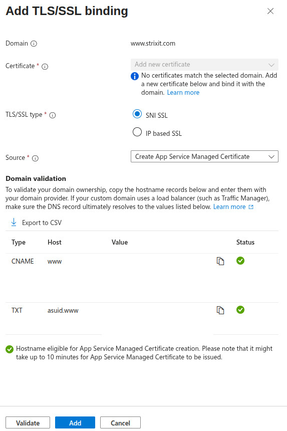

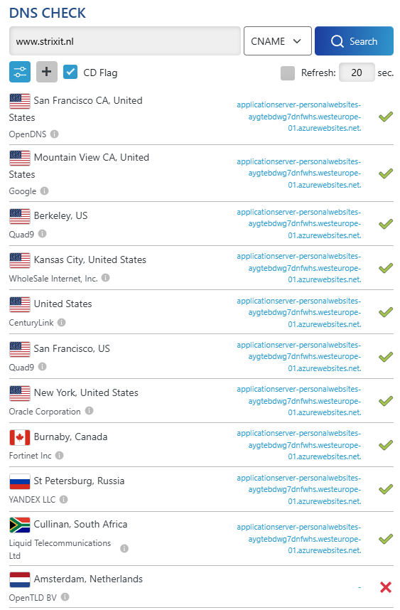

Adding a binding for my domain www.strixit.com via the Azure Portal's App Service's Custom domains tab keeps failing. Validation prior to trying to assign the binding works fine. I have been able to add a certificate to www.strixit.nl in the same way just fine. Can the problem be caused by me having had a custom certificate for this domain before?
I'm having the same problem with the apex domains. I can't assign add a binding to strixit.com, while it worked fine for strixit.nl. Here too validation before assigning the binding works fine.

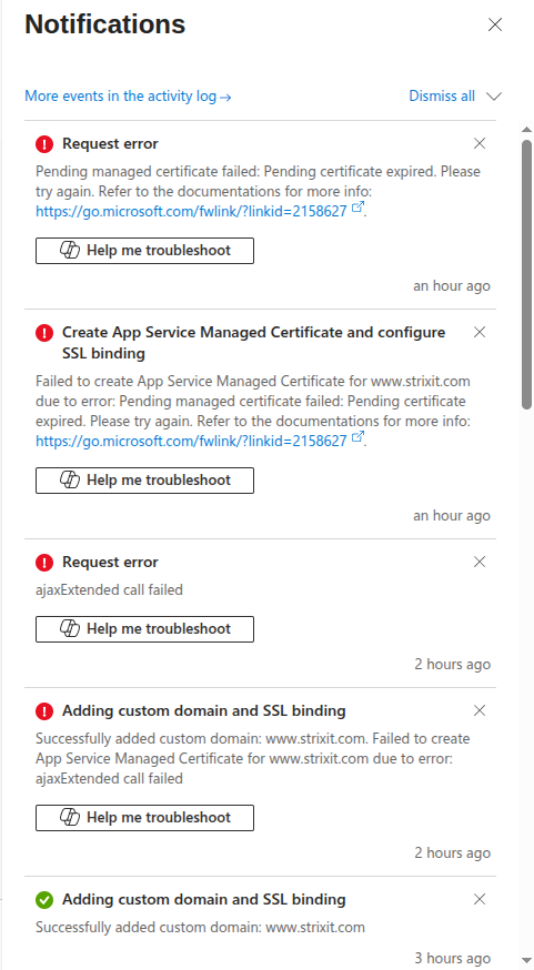

  2. Rutger Schurgers 0 Reputation points
    2026-05-03T15:23:21.87+00:00
    Hi Saraswathi and Kagiyama,
    Thanks for your responses. If I remember correctly, I used to have the www.strixit.com and strixit.com domains as custom domains with a Microsoft classic CDN. I never brought my own certificates. I don't have that resource anymore.The domains are currently not in use in any of my app services.I'm running a basic plan app service. The validation works fine and the error messages don't mention any problems:
    try-add-custom-domain
    Screenshot from 2026-05-03 17-14-28
    I've also tried removing the custom domain and adding it again. That doesn't change anything.
