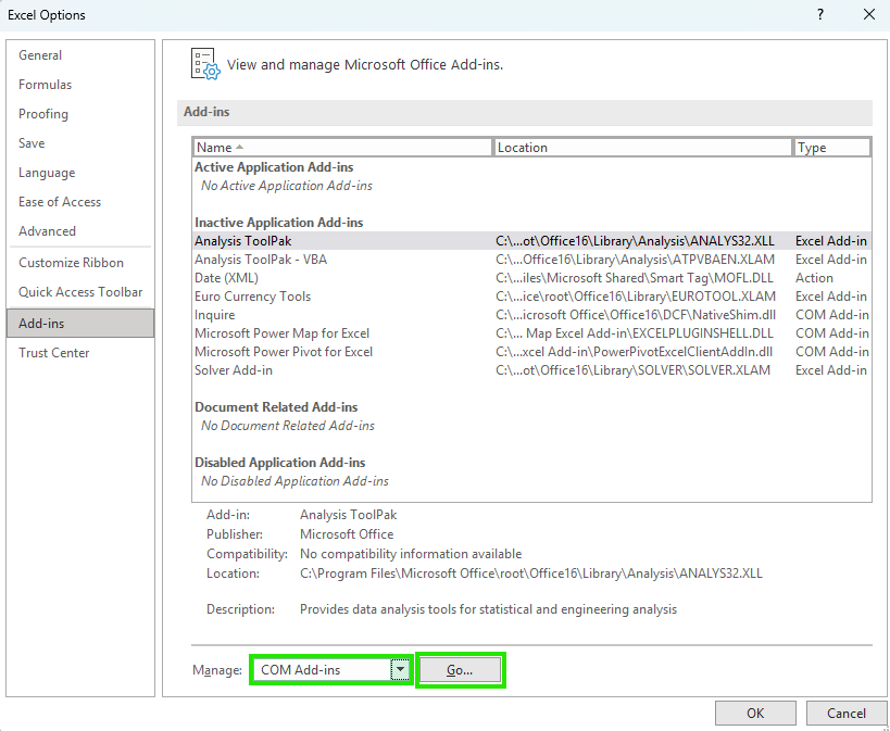

    Step 2: Verify the ADFDI Add‑In Is Enabled in Excel
    • Open Excel.
    • Go to File > Options > Add‑ins.
    • At the bottom, select COM Add‑ins and click Go.
    • Confirm that Oracle ADF Desktop Integration Add‑In for Excel is checked.

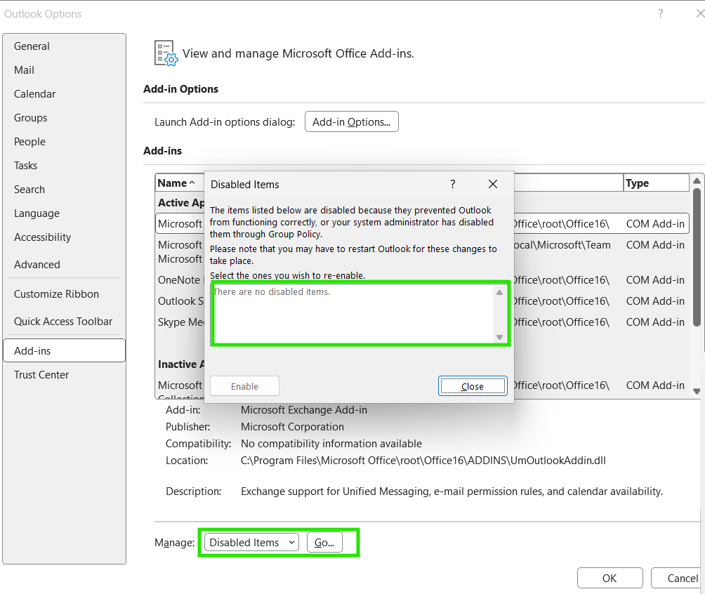

    • You can also go to Disable Items > Go... and check whether this add-in is disabled and enable it again. 
    • Click OK and restart Excel.
    If the add‑in is disabled or missing, the spreadsheet will open but remain blank.

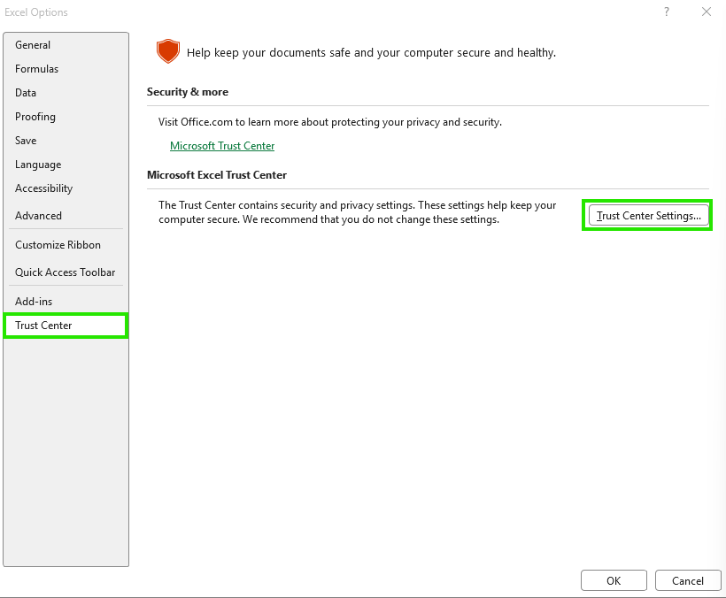

    Step 3: Configure Excel Trust Center and Macro Settings
    Although the file has been unblocked, could you please confirm whether the Excel Trust Center settings have been configured correctly? If not, please follow the steps below:

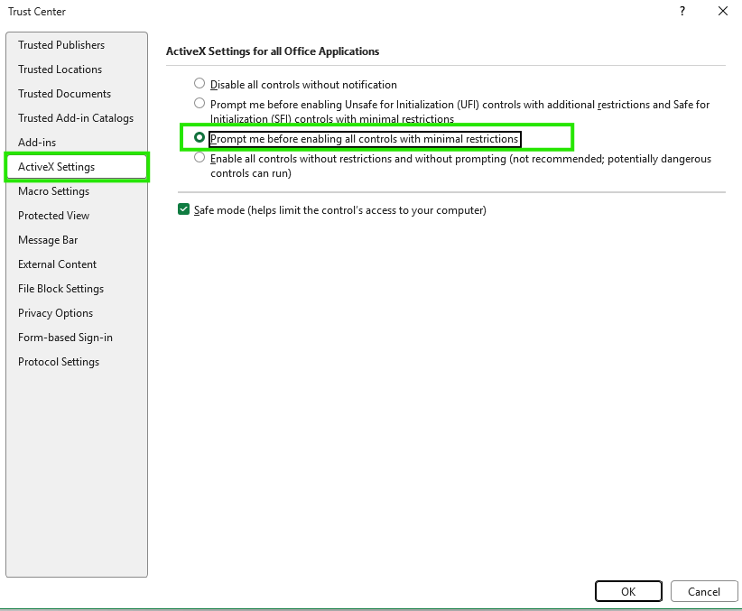

    • In Excel, go to File > Options > Trust Center > Trust Center Settings and apply the settings:
    • Macro Settings
      • Enable VBA macros
      • Trust access to the VBA project object model
    • ActiveX Settings: Prompt before enabling all controls

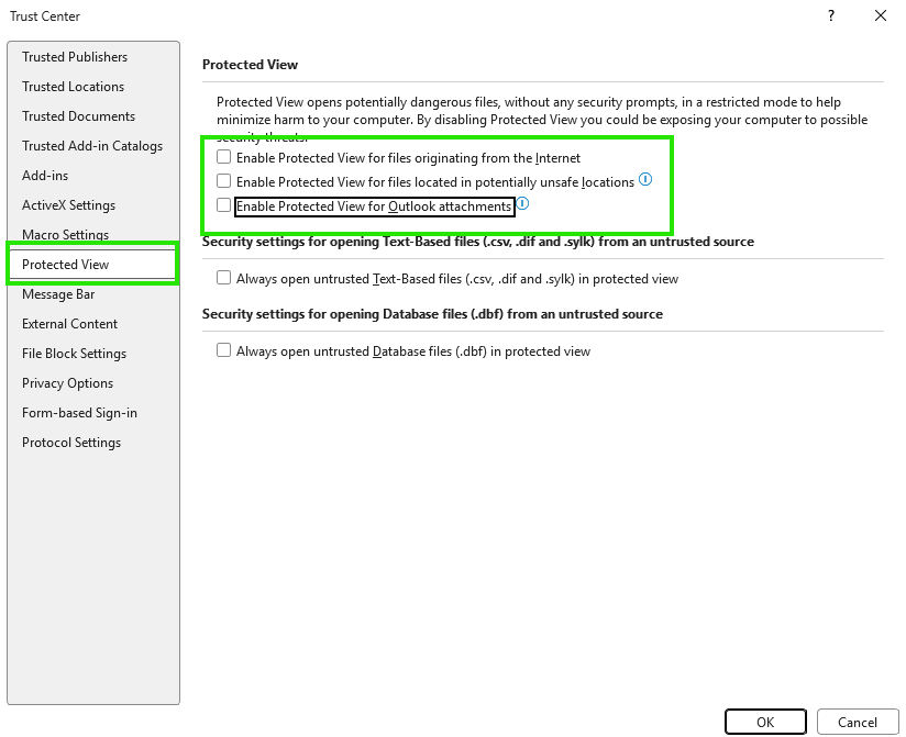

    • Protected View: Uncheck all options:
      • Files from the Internet
      • Potentially unsafe locations
      • Outlook attachments
    Please note that changes to Excel Trust Center settings should be applied temporarily for troubleshooting purposes only. Disabling these protections can increase security risk if left enabled long‑term.

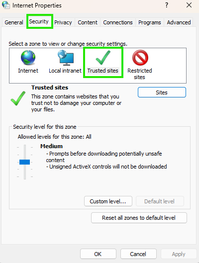

    Step 4: Add Oracle Fusion URL to Trusted Sites
    • Go to Control Panel > Network and Internet > Internet Options in Windows.
    • Go to the Security tab > Trusted Sites.
    • Add the URL where you download the file, for example: https://.oraclecloud.com or https://.oracle.com
    • Close all browser sessions and sign in again.
    Blocked authentication or web calls can prevent the spreadsheet from loading content.
