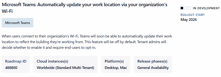

    After carefully reviewing your case, this behavior is most commonly attributed to a few specific conditions that are not immediately visible in the standard configuration checklist. First and foremost, it is worth noting that the Wi-Fi-based work location detection feature (Microsoft 365 Roadmap ID 488800) has undergone several rollout timeline changes, with General Availability currently targeted between early and late May 2026, meaning your tenant may not yet have received the update. Furthermore, there are two additional layers that can silently prevent detection from working: a granular in-app user consent setting within Teams that is separate from the Windows Location Services permission, and a working hours dependency that requires the user to have configured working hours in their Outlook or Teams calendar for the feature to trigger at all.
