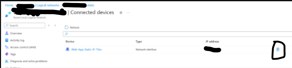

During Azure Migrate from a VMware to Azure HCI local, the error below occur, this is a domain controller. Any insight will be appreciated
An ARC service operation failed with error code: 'InUse', message: '{"REDACTED Customer resource details"
,"status":"Failed","startTime":"2026-04-27T23:03:55.0635451Z","endTime":"2026-04-27T23:04:00.211076Z","error":{"code":"InUse","message":"The moc-operator network interface service returned an error while reconciling: The address is already in use: Already Set: Failed","additionalInfo":[{"type":"ErrorInfo","info":{"category":"Uncategorized","recommendedAction":"","troubleshootingURL":""}}]}}', error message: 'The moc-operator network interface service returned an error while reconciling: The address is already in use: Already Set: Failed Status: 200 (OK) ErrorCode: InUse Service request succeeded. Response content and headers are not included to avoid logging sensitive data. '.

    • Ensure the DC’s IP is not included in the Azure Local logical network / IP pool (remove it if present).
    • Retry the migration with a temporary or different IP.
    • After the VM is successfully created, manually reassign the original static IP inside the guest OS.
    • If the IP remains locked, restart MOC services on the cluster nodes (e.g., MocHostAgent, HciCloudManagementSvc) to clear stale reservations.
