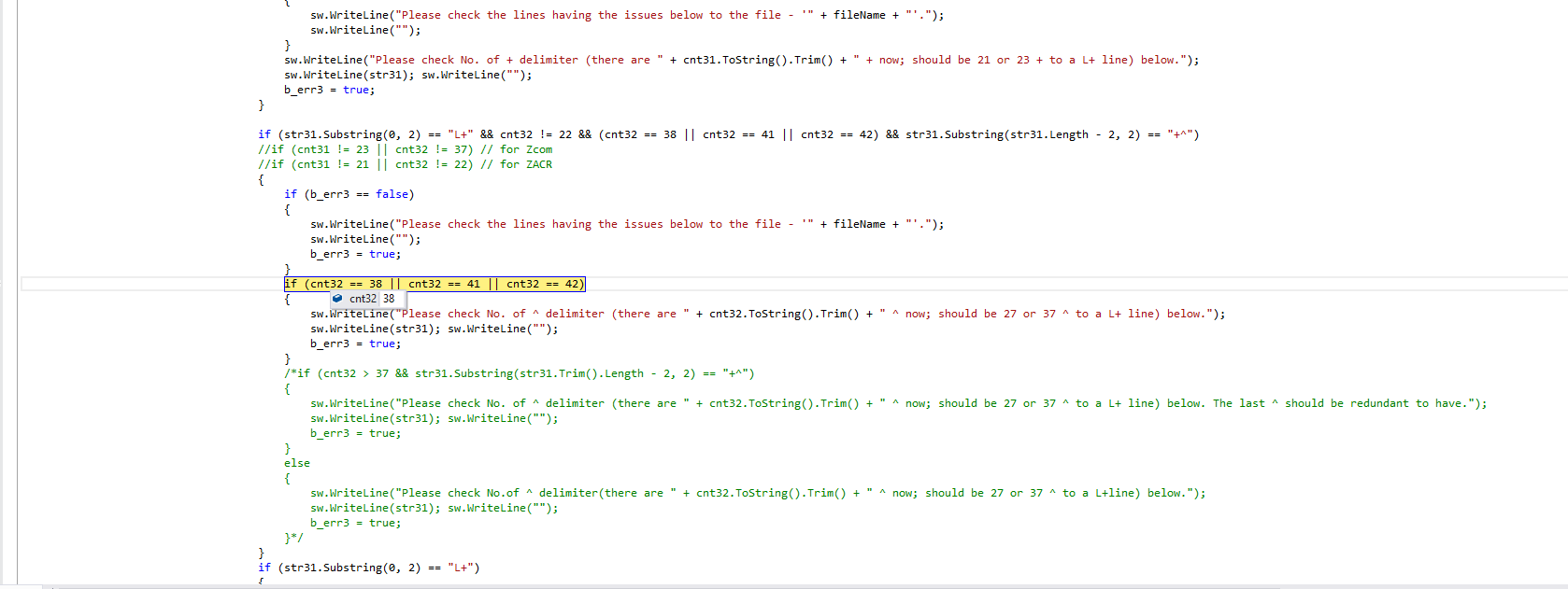

Running against the file below
https://1drv.ms/u/c/17ec75244bac022f/IQDksn7oBvAGSqa3I9pz8_dKAapU4-FWHovxVRFlkwrT5Tg?e=QdVOsH
the codes like
                                    if (cnt32 == 38 || cnt32 == 41 || cnt32 == 42)
                                        sw.WriteLine("Please check No. of ^ delimiter (there are " + cnt32.ToString().Trim() + " ^ now; should be 27 or 37 ^ to a L+ line) below.");
                                        sw.WriteLine(str31); sw.WriteLine("");
                                        b_err3 = true;
are not showing the messages to the text file. Is it possible that I put my program for anyone to have a look?
