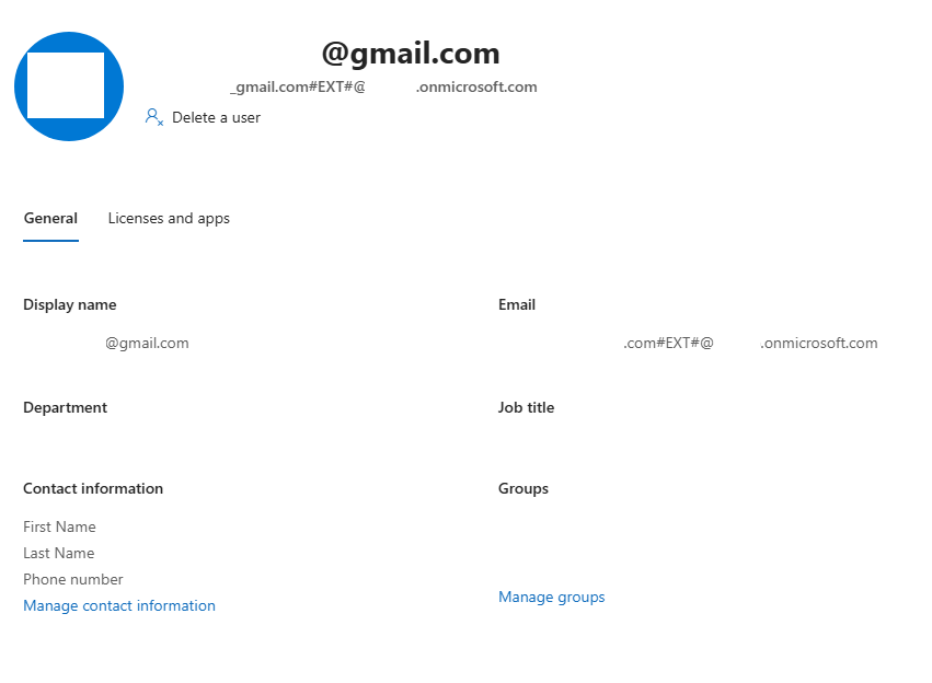

    They can review your guest account configuration and update your external display name (for example, changing it to the .email format) in the Microsoft 365 Admin Center>Active users > Users > Your accounts > Display name to ensure there is a clear distinction and avoid conflicts with your previous .com personal account.User's image
    This can help preserve the existing data associated with your account.
    However, if the issue persists, the IT administrator may consider removing your guest account and re-adding it to reset the identity association and resolve the conflict. Please note that this step could result in some data loss if the data's associated with the old external accounts.
