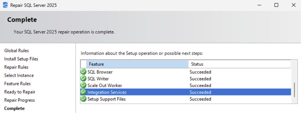

  • SSIS, (Integration Services) is installed. I even ran the Repair to verify that it is present.SQL3_SSIS

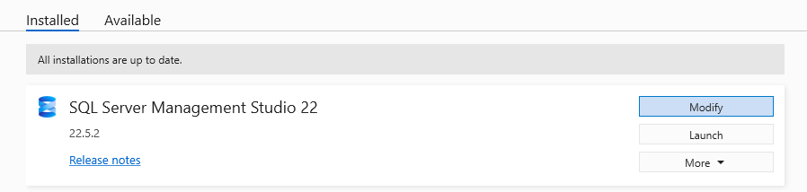

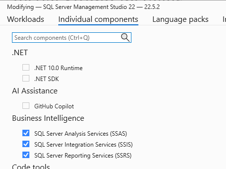

    You need to add support for SSIS to SSMS. In the Start menu, find Visual Studio Installer. When it starts, you will see something like this:
    Press Modify. On the page that comes up, select Individual components. You need to select SSIS and the installer will then add one of SSAS and SSRS, because there is some dependency.
