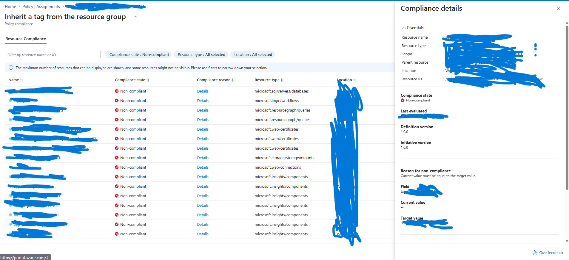

Hello, I want to ask whether it is possible to get this data from Azure Resource Graph

  2. This is the View Compliance Detail for the Assignments the policy is grouped at policy redacted The questions is:
    1. Is it possible to pull this data using Azure Resource Graph?

    Hello Tengku Aiman
    Thank you for reaching out to the Microsoft Q&A forum.
    When investigated you can absolutely pull policy‐compliance data out of Azure Resource Graph – at least the high-level stuff (which resources are compliant vs. non-compliant, when they were last evaluated, which assignment/definition they belong to, etc.). What you can’t get via Resource Graph is the deep “Compliance details” pane (the per-setting or per-field “Current value” vs. “Target value” info). For that, you’d need to call the Policy Insights APIs (or use az policy state list / PowerShell) instead.
    Here’s a quick sample ARG query to list all non-compliant resources for a given assignment:
    // Replace with your real assignment ID:
    let assignmentId = '/subscriptions/00000000-0000-0000-0000-000000000000/providers/Microsoft.Authorization/policyAssignments/InheritTagRG';
    policyresources
    | where properties.policyAssignmentId == assignmentId
          and properties.complianceState == 'NonCompliant'
    | extend
        resourceId    = properties.resourceId,
        resourceType  = tostring(split(properties.resourceId, '/')[6])
                      + '/' + tostring(split(properties.resourceId, '/')[7]),
        location      = properties.resourceLocation,
        lastEvaluated = properties.timestamp
    | project resourceId, resourceType, location, lastEvaluated
    If you need the extra “Compliance reason” details (fields, current value, target value), switch over to the Policy Insights REST API or CLI:
    az policy state list \
      --assignment '/subscriptions/…/providers/Microsoft.Authorization/policyAssignments/InheritTagRG' \
      --filter "complianceState eq 'NonCompliant'" \
      --query "[].{resource:resourceId, reason:complianceReason, details:policyDefinitionAction}" \
      --output table
    Let me know if any further queries - feel free to reach out!

    2026-05-05T06:18:26.3066667+00:00
    Yes. Azure Policy compliance data, including per-assignment and per-resource compliance state, can be queried through Azure Resource Graph.
    Azure Policy continuously evaluates resources and produces compliance results. These results are exposed in several ways, one of which is Azure Resource Graph queries. The compliance information that appears in the View compliance details blade for a policy assignment is part of this same data set.
    To work with it at scale:
    1. Ensure policy evaluations have run so that compliance state is up to date (policy evaluation cycles are what populate the compliance data).
    2. Use Azure Resource Graph to query the policy compliance resources. From the documentation, Azure Policy compliance data is explicitly listed as one of the ways to access compliance information, alongside the Azure portal, command line, and Azure Monitor logs.
    This allows pulling the same compliance details shown in the portal (for example, which resources are compliant or non-compliant for the built-in policy Inherit a tag from the resource group) via Resource Graph queries.
