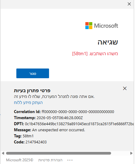

Hi, I have an issue with an Office 365 product on a terminal farm environment with 1 RDG and 2 RDSH servers 2025 windows that use FSLogix profiles and Office 365 containers.
Does anyone know why this is happening to some of my users in this environment?

  3. VPHAN 30,935 Reputation points Independent Advisor
    2026-05-05T07:31:05.05+00:00
    Hi Ross Nishuler,
    The error code 2147942403 means a path-not-found exception, and the 58tm1 tag points to a failure within the Web Account Manager during the Office 365 authentication process. In an environment utilizing FSLogix on remote desktop session hosts, this indicates that the Azure AD Broker Plugin is either corrupted or its necessary directories are being aggressively excluded by your redirections configuration as users roam between nodes. When the broker can't locate its stored identity tokens or the plugin files themselves, the sign-in prompt crashes.
    To permanently resolve this across the terminal farm, you must verify that your FSLogix redirections XML is not excluding the Microsoft.AAD.BrokerPlugin_cw5n1h2txyewy folder. For users who are currently stuck with the error, you will need to clear the corrupted state by having them sign out completely to release any file locks. Next, navigate to their profile path at %LOCALAPPDATA%\Packages\ and rename or remove both the Microsoft.AAD.BrokerPlugin_cw5n1h2txyewy and the TokenBroker directories. Once those directories are cleared, the operating system will rebuild a fresh cache during the next logon attempt, which forces a clean request for identity tokens from Microsoft Entra and eliminates the path-not-found exception without requiring a complete wipe of the user's profile container.
