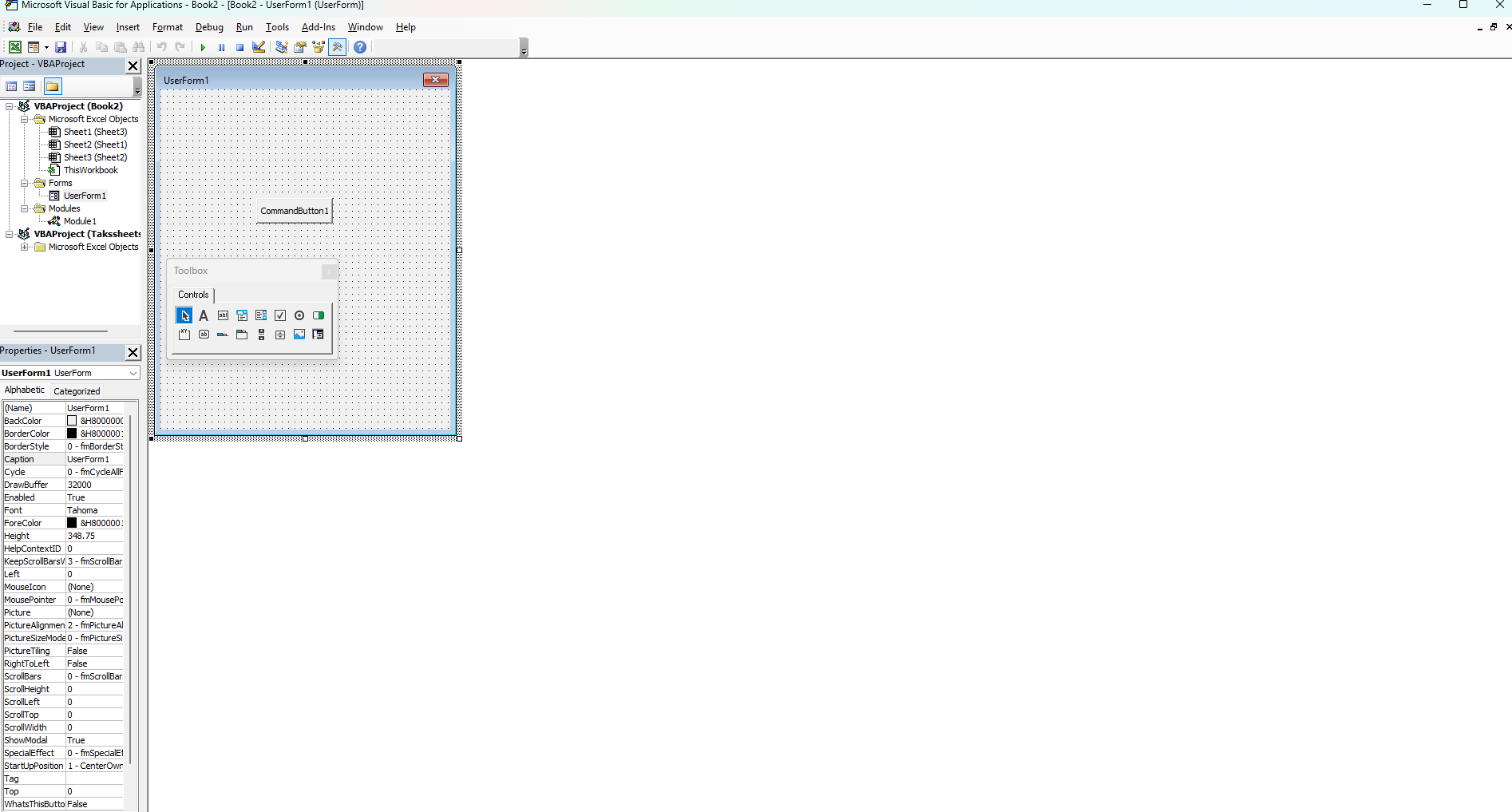

Things seem to have changed in VBA since I last wrote any code. I am designing a small project for home use, using Excel and VBA. I find I can add controls to a userform but I cannot change their properties at design time. For example, I have a CommandButton which I want to rename, but I cannot open a useful Properties Window (F4). I have changed Activex preferences in the Trust Centre but Nothing seems to have any effect. Advice, please?

    This comes down to the context in the VBA editor rather than a change in VBA itself. The key is to make sure you’re editing the control from the UserForm designer. Open the editor with Alt + F11, then in Project Explorer double-click the UserForm so it’s open in design view. Click the specific control once so only that control is selected, and then either press F4 or go to View -> Properties Window.
    When the correct object is selected, the Properties window should show entries like (Name) and Caption. (Name) is what you reference in code, while Caption is the text displayed on the control. If what opens doesn’t look like that, it’s often because the code window is active instead of the form, the form itself is selected, or multiple controls are selected at once.

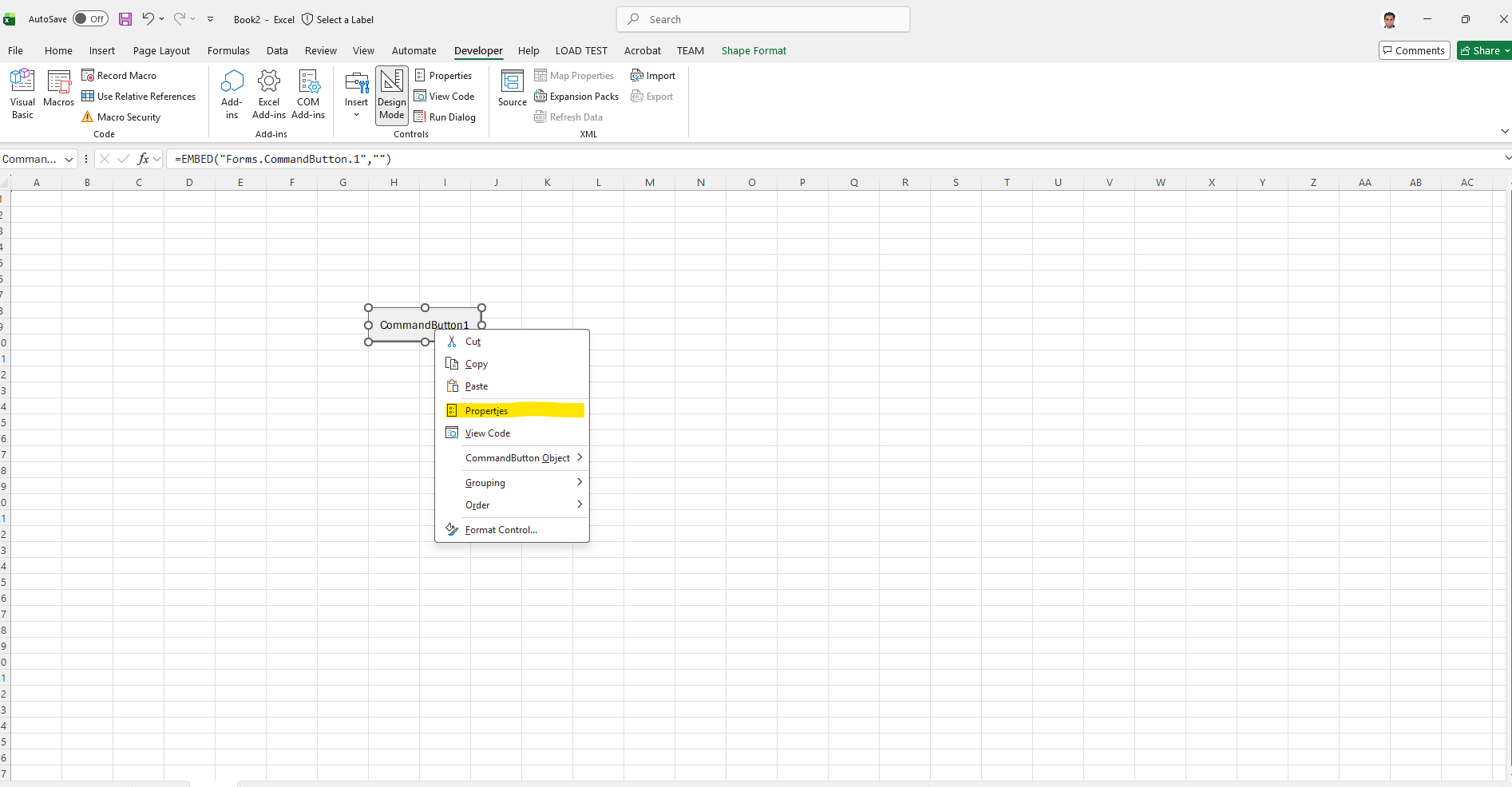

    If you’re working with a control placed directly on a worksheet rather than inside a UserForm, switch on Design Mode from the Developer tab first, then access Properties from there or by right-clicking the control.

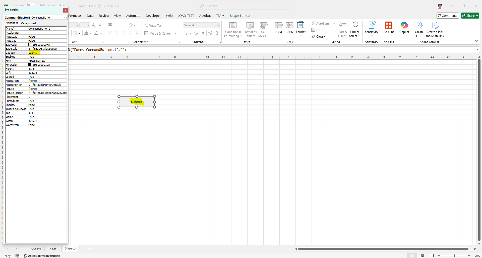

    Sheet Design
    • add controls then right click goto properties.
    • goto caption give your desired name.

    1. Open the Visual Basic Editor (VBE) from Excel (Developer tab → Visual Basic, or press ALT+F11).
    2. In the Project Explorer, double‑click the UserForm to open it in design mode.
    3. Click once on the CommandButton (or other control) on the UserForm so it is selected.
    4. Press F4, or on the VBE menu choose View → Properties Window.
    5. In the Properties window:
      • Confirm the Object box at the top shows the selected control (for example, CommandButton1). Only objects from the active form are visible.
      • Use the Alphabetic or Categorized tab to locate properties.
      • To rename the control (the name used in code), change the (Name) property.
      • To change the text shown on the button, change the Caption property.
    If multiple controls are selected, only properties common to all of them are shown. Ensure only the intended control is selected if some properties appear to be missing.

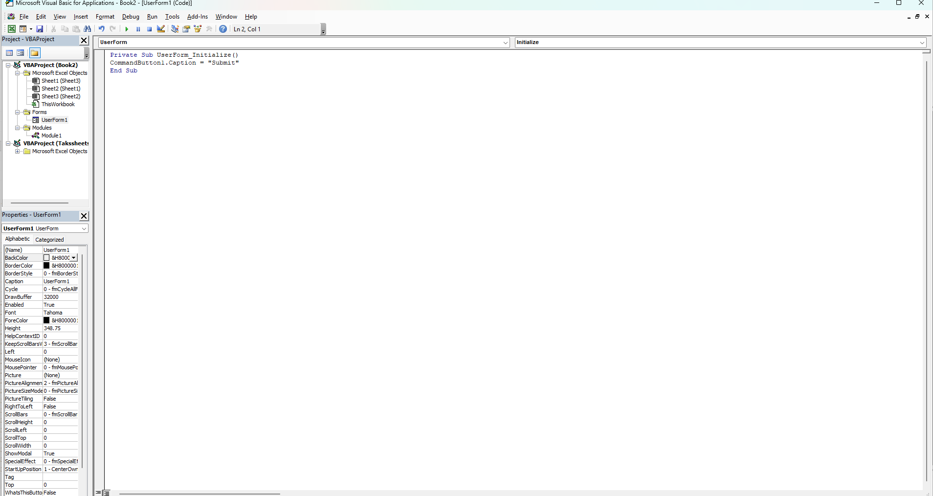

    If design‑time changes are not possible for some reason, the same properties can be set in code. For example, from the UserForm’s code module:
    Private Sub UserForm_Initialize()
        'Change the name used in code is done only in the Properties window, not here
        'Change the caption (text on the button) at run time
        Me.CommandButton1.Caption = "Run"
    End Sub
    For ActiveX controls placed directly on a worksheet (instead of on a UserForm):
    1. On the worksheet, turn on Developer → Controls → Design Mode.
    2. Click the ActiveX control (e.g., Command Button) to select it.
    3. On the Developer tab, in the Controls group, click Properties (or right‑click the control and choose Properties).
    4. In the Properties box, change (Name) to rename the control for use in code, and Caption to change the text on the button.
