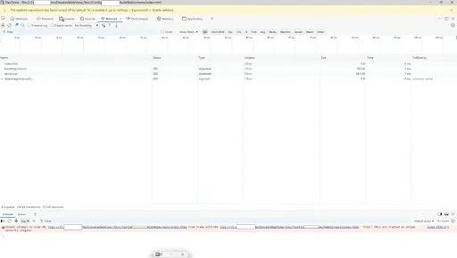

  • We have developed a C++ application which starts on system startup. This is configured through 'Winlogon/shell' registry value. UAC is configured as enable on the system.
  • CPP application on launch spawns a C#,WebView2 application. However it fails to execute or shows white screen issues. We understand this is due to running WebView2 application in admin/privileged mode.
  • We can not create new user with standard privileges or we can not use 'explorer.exe' that establishes runtime environment for WebView2 application. These are our environment restrictions.
  • Through ShellLauncherV2 approach also we need new standard user available, thus it can not be used as well.
Request to please suggest an approach where we can spawn C#,WebView2 application safely without any issue.
