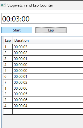

I recreated a minimal WPF project using your posted code as closely as possible, adding only the components required to build and run it. I was able to reproduce the issue: the first lap appeared correctly, but additional clicks of the Lap button did not update the UI:
After changing the collection to ObservableCollection(Of Lap) and ensuring that Laps.Add(...) runs on the UI thread, all laps appeared correctly in the DataGrid.
Result after the fix:

Public ReadOnly Property Laps As New ObservableCollection(Of Lap)()
Private Sub CreateLap(
    sender As Object,
    e As RoutedEventArgs
) Handles btnLap.Click
    SaveLap()
End Sub
Private Sub SaveLap()
    Dim duration As TimeSpan =
        CurrentTime - PreviousLapTime
    LapCount += 1
    Laps.Add(
        New Lap With {
            .Count = LapCount,
            .Duration = duration
    PreviousLapTime = CurrentTime
End Sub
Your existing DataGrid binding can remain essentially unchanged.
There is no need to raise PropertyChanged(NameOf(Laps)) after each Add(). ObservableCollection sends the required collection notification automatically.
