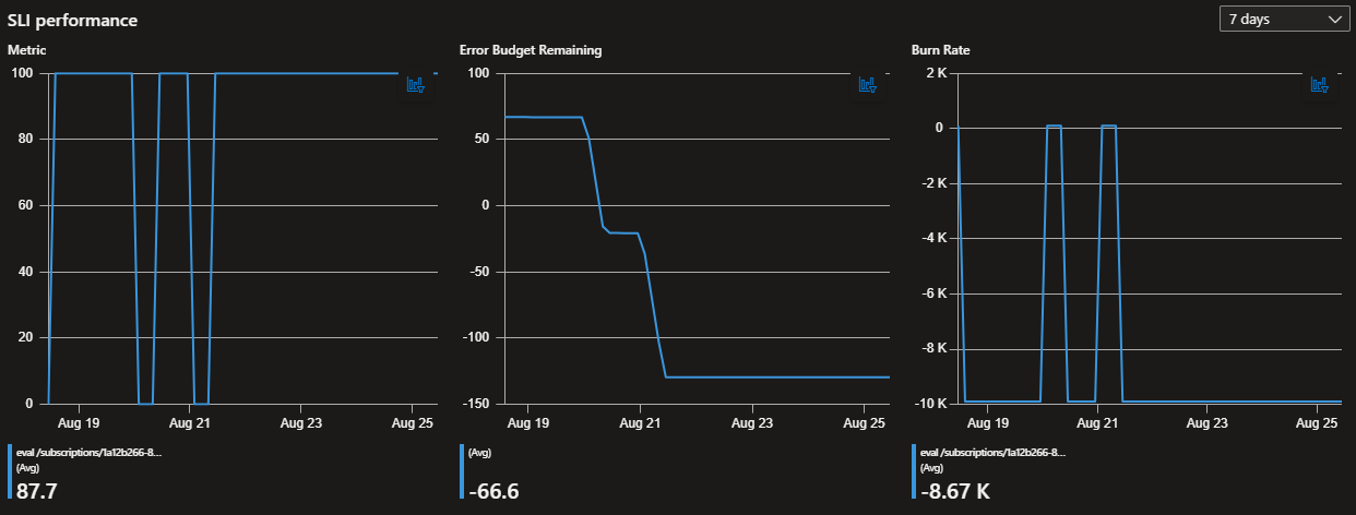

I am observing an unexpected Burn Rate chart for an Azure Monitor Service Group SLI created with Microsoft.Monitor/slis@2025-03-01-preview.
Configuration:
  • SLI type: Availability
  • Evaluation method: RequestBased
  • Baseline: 99%
  • Compliance period: 7 rolling days
  • Window size: 5 minutes
  • Good and total signals use Sum aggregation
  • Source metrics satisfy 0 <= good <= total and never contain negative values
In the attached 7-day chart:
  • The SLI metric is approximately 100 during healthy periods and 0 during failed periods.
  • The Burn Rate is approximately -10K during healthy periods and returns to approximately 0 during failed periods.
  • The displayed averages are 87.7 for the SLI and -8.67K for Burn Rate.
The Burn Rate series therefore appears inverted and approximately proportional to -100 × SLI, rather than representing the rate at which the error budget is consumed.
The Error Budget Remaining chart becomes negative after the budget is exhausted. A negative remaining budget may be intentional, although its exact unit and calculation are not documented. My primary concern is the Burn Rate: a consumption rate should normally be non-negative and should increase when the SLI deteriorates, but this chart behaves in the opposite direction.
Could you clarify:
  1. What exact formula and unit does Azure Monitor use for these charts?
  2. Is a negative Burn Rate expected?
  3. Is this a known calculation, scaling, or portal visualization issue for RequestBased SLIs?
スクリーンショット 2026-08-25 110020
The source good and total metrics have been verified as non-negative, with the good value never exceeding the total value.In the attached 7-day chart:
Could you clarify:

  1. Allan Solomon Mejia 6,240 Reputation points
    2026-08-25T02:39:40.9566667+00:00
    Hello @Toru Makabe
    Given the values you provided, I shouldn't treat the negative burn rate as expected behavior.
    Microsoft refers to burn rate as the rate at which the SLI uses up its error budget. With a 99% baseline, the error budget allowed is 1%. The burn rate should increase as failures use up that budget; a healthy SLI must not result in a large negative burn rate.
    The source metrics satisfy 0 <= good <= total, but since the chart shows about -10K while the SLI is healthy and tends toward zero during failures, the series shown does not seem to match Microsoft's stated burn-rate semantics.
    The current documentation provides only a conceptual explanation of burn rate rather than specifying the calculation or the units involved.
    Since the SLI resource/API you're using is still in preview, the issue may be a calculation or display error in the portal rather than anything wrong with your good/total signals. In that case, I suggest you open an Azure support case and include the SLI resource ID, the ARM definition, screenshots, and sample values for the good/total metrics so the Azure Monitor team can verify the backend calculation.
