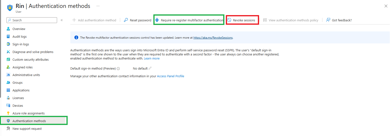

From what you've described, this does appear to be an MFA (multi-factor authentication) issue, where the Microsoft Authenticator app is not receiving the approval prompt or code needed to complete the sign-in process. This can unfortunately create a situation where you're unable to access either your account or the settings needed to fix the problem yourself.
In this situation, since you are using a college/school account, the best course of action is to contact your school's IT administrator. They have the necessary permissions to reset your multi-factor authentication settings and help restore access to your account.
You can ask them to follow the steps outlined in the following guide to revoke your existing MFA sessions and require MFA re-registration: Manage authentication methods for Microsoft Entra multifactor authentication - Microsoft Entra ID |…
This process typically takes only a few minutes. It clears the existing authentication registration and sign-in sessions, and the next time you sign in, you should be prompted to set up Microsoft Authenticator again from scratch on your phone.

    7. If the phone was replaced, lost, broken, or no other method is available, contact the college IT help desk and ask them to clear/reset MFA settings or require re-register of multi-factor authentication.
      • After they clear the old methods, the next sign-in should prompt for MFA setup again.
      • This is the required path when the account is managed by the school and only Authenticator is configured.
