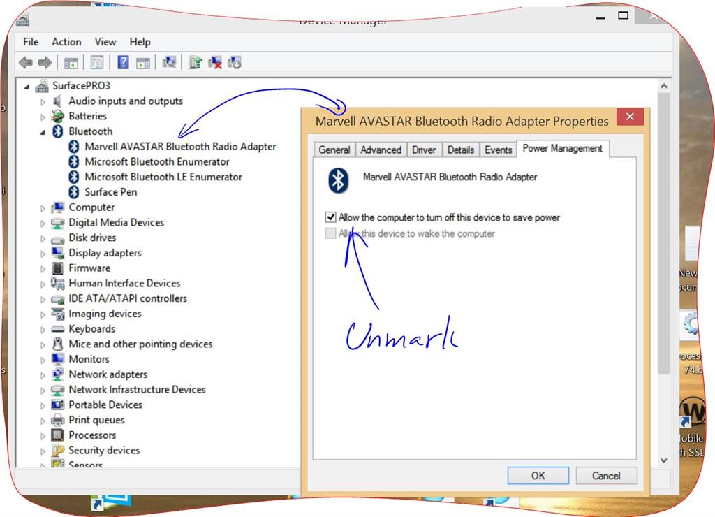

Hello SdSurfer,
Thank you for posting to the Community. I am sorry to hear about the issue you are experiencing with your Bluetooth device when paired with your newly purchased Surface Pro 3. Please rest assured, I am here to help.
I understand you have been able to fully use the Bluetooth device with the Surface Pro 3, however the issue arises solely after your Surface Pro 3 returns from Sleep mode or turned off.
This can occur when the system automatically turns off your Bluetooth device to save power when it detects that you've entered into idle mode.
Please give the steps below a try and see if it resolves your issue in particular.
First make sure your device has the latest updatesfully installed.
Then:
  1. Open Device Manager
  2. Expand the "Bluetooth" options.
  3. From the list double click the "Marvel AVASTART Bluetooth Radio Adapter".
  4. Click the "Power Management" tab.
  5. Uncheck the check box "Allow the computer to turn off this device to save power."
  6. Click the "Save" button to save the settings.
Ultimately, you can also click here for steps on how to troubleshoot inconsistencies with Bluetooth devices.
Please try the steps provided above and let us know how it all worked out for you.

    You can also refer to the screenshot provided in CtitanicMVP reply above to easily locate the settings I am referring to in the steps provided.
